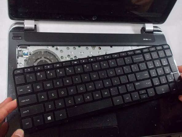

  3. HP Pavilion 15-n210dx Hard Drive Replacement, Keyboard: crwdns2935265:03crwdnd2935265:01crwdnd2935265:01crwdne2935265:0
    • Turn over the laptop and remove the single screw using a Tri-point Y0 screwdriver.
  4. HP Pavilion 15-n210dx Hard Drive Replacement: crwdns2935265:04crwdnd2935265:01crwdnd2935265:01crwdne2935265:0
    • Open the laptop and use a spudger gently to get under the keyboard. Loosen the keyboard on all sides and then lift it up.

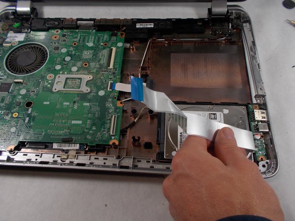

  5. HP Pavilion 15-n210dx Hard Drive Replacement: crwdns2935265:05crwdnd2935265:01crwdnd2935265:02crwdne2935265:0 HP Pavilion 15-n210dx Hard Drive Replacement: crwdns2935265:05crwdnd2935265:02crwdnd2935265:02crwdne2935265:0
    • Use the spudger to unhinge the fastener and remove the connector.
    • The keyboard should be completely detached from the computer now.

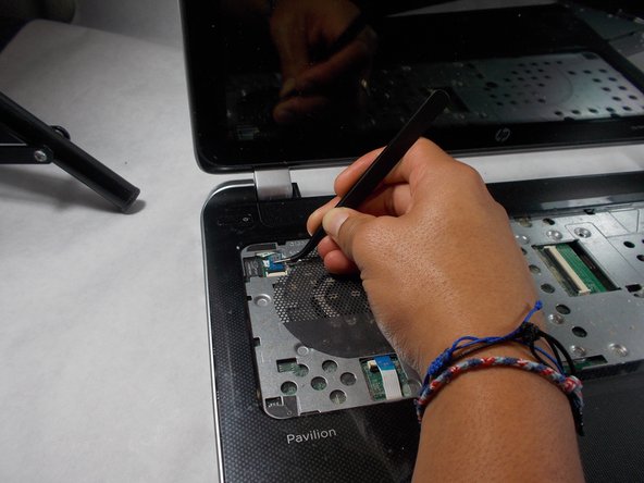

  6. HP Pavilion 15-n210dx Hard Drive Replacement, Hard Drive: crwdns2935265:06crwdnd2935265:01crwdnd2935265:01crwdne2935265:0
    • Use the Tri-point Y0 screwdriver to remove all screws on the metal sheet, then remove the metal sheet.

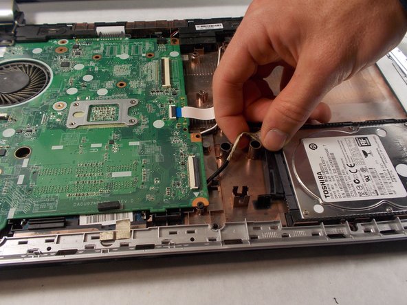

  7. HP Pavilion 15-n210dx Hard Drive Replacement: crwdns2935265:07crwdnd2935265:01crwdnd2935265:02crwdne2935265:0 HP Pavilion 15-n210dx Hard Drive Replacement: crwdns2935265:07crwdnd2935265:02crwdnd2935265:02crwdne2935265:0
    • Remove the two blue wire connectors using the reverse tweezers and lift up on the two wires to disconnect them.

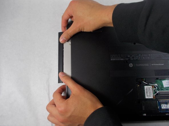

  9. HP Pavilion 15-n210dx Hard Drive Replacement: crwdns2935265:09crwdnd2935265:01crwdnd2935265:02crwdne2935265:0 HP Pavilion 15-n210dx Hard Drive Replacement: crwdns2935265:09crwdnd2935265:02crwdnd2935265:02crwdne2935265:0
    • Remove the optic drive by pushing the edge with your thumbs to open it. Once open use two hands to remove it entirely.
