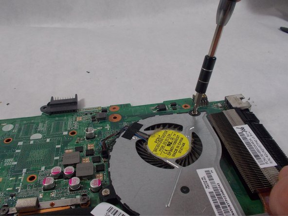

  19. HP Pavilion 15-n210dx Fan Replacement: crwdns2935265:019crwdnd2935265:01crwdnd2935265:02crwdne2935265:0 HP Pavilion 15-n210dx Fan Replacement: crwdns2935265:019crwdnd2935265:02crwdnd2935265:02crwdne2935265:0
    • Remove the two screws using the Phillips #0 screwdriver.

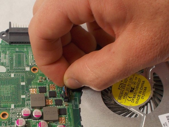

  20. HP Pavilion 15-n210dx Fan Replacement: crwdns2935265:020crwdnd2935265:01crwdnd2935265:02crwdne2935265:0 HP Pavilion 15-n210dx Fan Replacement: crwdns2935265:020crwdnd2935265:02crwdnd2935265:02crwdne2935265:0
    • Using your thumb and index finger, grasp the wires closes to the motherboard and pull up to detach them from the motherboard.
