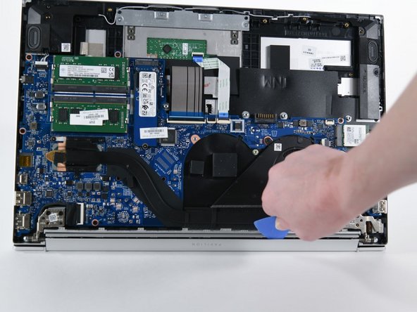

    • Slide the opening pick around the edges of the laptop where the chassis has a seam.
    • You will hear a clicking noise as you undo the clips of the chassis.
    • It may be easier to start with the four corners of the laptop, and then follow through with the sides.
  4. HP Pavilion 15-eg0025nr Screen Replacement: crwdns2935265:04crwdnd2935265:01crwdnd2935265:01crwdne2935265:0
    • Remove the back panel completely.
    • With the back panel removed, you can now access parts of the laptop such as the fan or the battery.

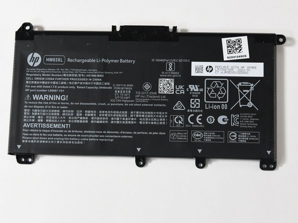

  5. HP Pavilion 15-eg0025nr Screen Replacement, Battery: crwdns2935265:05crwdnd2935265:01crwdnd2935265:01crwdne2935265:0
    • Remove the five screws from the battery using a Phillips #00 screwdriver.
  6. HP Pavilion 15-eg0025nr Screen Replacement: crwdns2935265:06crwdnd2935265:01crwdnd2935265:02crwdne2935265:0 HP Pavilion 15-eg0025nr Screen Replacement: crwdns2935265:06crwdnd2935265:02crwdnd2935265:02crwdne2935265:0
    • Remove the battery from the laptop.

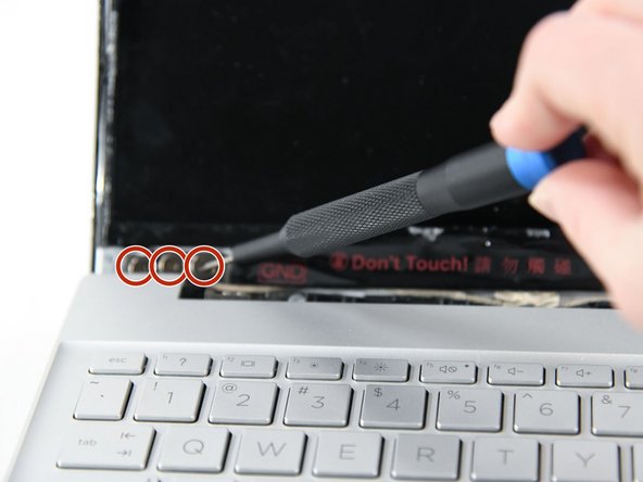

  7. HP Pavilion 15-eg0025nr Screen Replacement, Screen: crwdns2935265:07crwdnd2935265:01crwdnd2935265:03crwdne2935265:0 HP Pavilion 15-eg0025nr Screen Replacement, Screen: crwdns2935265:07crwdnd2935265:02crwdnd2935265:03crwdne2935265:0 HP Pavilion 15-eg0025nr Screen Replacement, Screen: crwdns2935265:07crwdnd2935265:03crwdnd2935265:03crwdne2935265:0
    • Do not attempt to remove the screen without first removing the back panel and battery. Ensure that the laptop is powered off before removing the screen

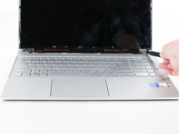

    • Find the hinge bezel where the display bezel meets the back panel.
    • Using an opening pick, unclip the hinge bezel by sliding the pick along the hinge.
  8. HP Pavilion 15-eg0025nr Screen Replacement: crwdns2935265:08crwdnd2935265:01crwdnd2935265:03crwdne2935265:0 HP Pavilion 15-eg0025nr Screen Replacement: crwdns2935265:08crwdnd2935265:02crwdnd2935265:03crwdne2935265:0 HP Pavilion 15-eg0025nr Screen Replacement: crwdns2935265:08crwdnd2935265:03crwdnd2935265:03crwdne2935265:0

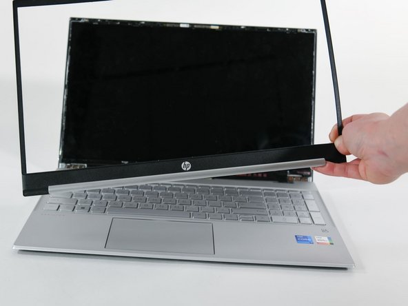

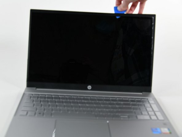

    • Using an opening pick, pry open the top, sides, and bottom of the display bezel.
    • Remove the display bezel and set aside.
  9. HP Pavilion 15-eg0025nr Screen Replacement: crwdns2935265:09crwdnd2935265:01crwdnd2935265:03crwdne2935265:0 HP Pavilion 15-eg0025nr Screen Replacement: crwdns2935265:09crwdnd2935265:02crwdnd2935265:03crwdne2935265:0 HP Pavilion 15-eg0025nr Screen Replacement: crwdns2935265:09crwdnd2935265:03crwdnd2935265:03crwdne2935265:0
    • Remove the six golden screws with a Phillips #00 screwdriver and set aside.
    • There are three screws on each side.
  10. HP Pavilion 15-eg0025nr Screen Replacement: crwdns2935265:010crwdnd2935265:01crwdnd2935265:02crwdne2935265:0 HP Pavilion 15-eg0025nr Screen Replacement: crwdns2935265:010crwdnd2935265:02crwdnd2935265:02crwdne2935265:0

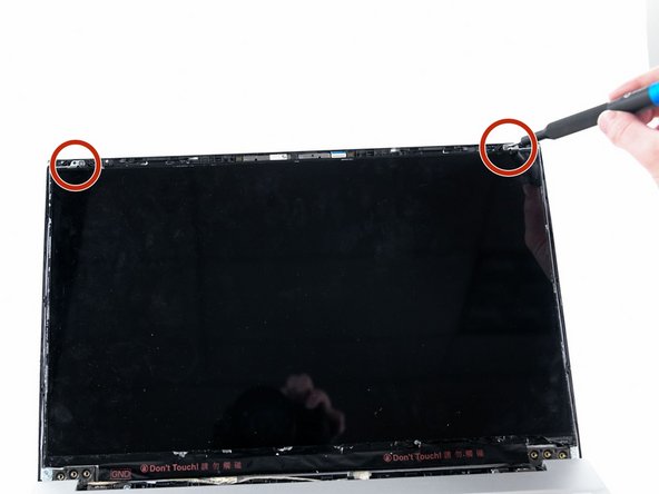

    • Remove the two silver screws at the top of the display panel with a Phillips #00 screwdriver.
  11. HP Pavilion 15-eg0025nr Screen Replacement: crwdns2935265:011crwdnd2935265:01crwdnd2935265:03crwdne2935265:0 HP Pavilion 15-eg0025nr Screen Replacement: crwdns2935265:011crwdnd2935265:02crwdnd2935265:03crwdne2935265:0 HP Pavilion 15-eg0025nr Screen Replacement: crwdns2935265:011crwdnd2935265:03crwdnd2935265:03crwdne2935265:0

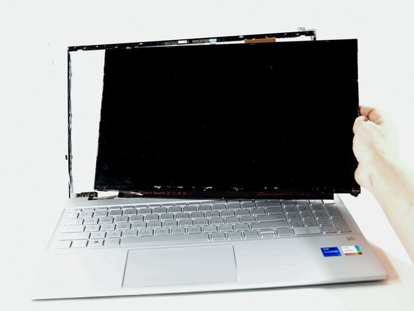

    • Using an opening pick, carefully pry the screen from top, sides, and bottom of the display panel.
    • Be cautious to not bend or snap the screen as you pry it out.
    • Remove the screen and set aside.
