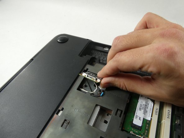

  4. HP Pavilion 15-e043cl Wi-Fi Card Replacement, Wi-Fi Card: crwdns2935265:04crwdnd2935265:01crwdnd2935265:01crwdne2935265:0
    • Use tweezers to remove the white and black mini jumper cable attached to the Wi-Fi card.
  5. HP Pavilion 15-e043cl Wi-Fi Card Replacement: crwdns2935265:05crwdnd2935265:01crwdnd2935265:02crwdne2935265:0 HP Pavilion 15-e043cl Wi-Fi Card Replacement: crwdns2935265:05crwdnd2935265:02crwdnd2935265:02crwdne2935265:0
    • Remove the single 2.5 mm screw with a Phillips #0 screwdriver from the Wi-Fi card.
    • Lift the Wi-Fi card out of the device.
