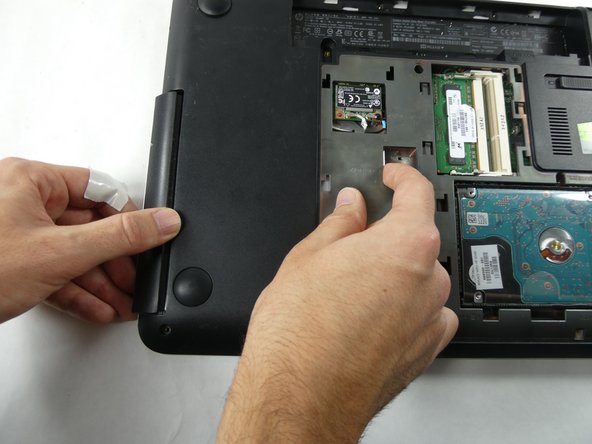

    • Flip the device over.
    • Slide the battery switch on the right half of the laptop.
    • Make sure the device is powered off, and that it is not connected to any power sources.
  2. HP Pavilion 15-e043cl Optical Drive Replacement: crwdns2935265:02crwdnd2935265:01crwdnd2935265:02crwdne2935265:0 HP Pavilion 15-e043cl Optical Drive Replacement: crwdns2935265:02crwdnd2935265:02crwdnd2935265:02crwdne2935265:0
    • Lift the battery up and out of the device by the inward-facing edge.
  3. HP Pavilion 15-e043cl Optical Drive Replacement, Maintenance Panel: crwdns2935265:03crwdnd2935265:01crwdnd2935265:03crwdne2935265:0 HP Pavilion 15-e043cl Optical Drive Replacement, Maintenance Panel: crwdns2935265:03crwdnd2935265:02crwdnd2935265:03crwdne2935265:0 HP Pavilion 15-e043cl Optical Drive Replacement, Maintenance Panel: crwdns2935265:03crwdnd2935265:03crwdnd2935265:03crwdne2935265:0
    • Unscrew the single Phillips #0 captive screw that was previously hidden by the battery.
    • The screw can not, and should not, be fully removed.
    • Slide the maintenance panel away from the battery compartment to release it.
  4. HP Pavilion 15-e043cl Optical Drive Replacement, Optical Drive: crwdns2935265:04crwdnd2935265:01crwdnd2935265:02crwdne2935265:0 HP Pavilion 15-e043cl Optical Drive Replacement, Optical Drive: crwdns2935265:04crwdnd2935265:02crwdnd2935265:02crwdne2935265:0
    • Remove the black screw nearby to the disk tray.
    • Push the disk tray out of the laptop near the stamp that says "RELEASE."
