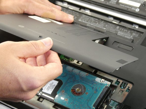

  3. HP Pavilion 15-e043cl Hard Drive Replacement, Maintenance Panel: crwdns2935265:03crwdnd2935265:01crwdnd2935265:03crwdne2935265:0 HP Pavilion 15-e043cl Hard Drive Replacement, Maintenance Panel: crwdns2935265:03crwdnd2935265:02crwdnd2935265:03crwdne2935265:0 HP Pavilion 15-e043cl Hard Drive Replacement, Maintenance Panel: crwdns2935265:03crwdnd2935265:03crwdnd2935265:03crwdne2935265:0
    • Unscrew the single Phillips #0 captive screw that was previously hidden by the battery.
    • The screw can not, and should not, be fully removed.
    • Slide the maintenance panel away from the battery compartment to release it.

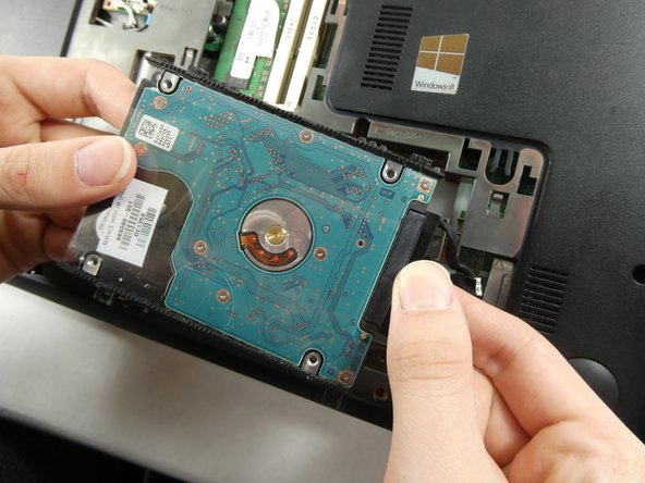

  4. HP Pavilion 15-e043cl Hard Drive Replacement, Hard Drive: crwdns2935265:04crwdnd2935265:01crwdnd2935265:02crwdne2935265:0 HP Pavilion 15-e043cl Hard Drive Replacement, Hard Drive: crwdns2935265:04crwdnd2935265:02crwdnd2935265:02crwdne2935265:0
    • Unscrew the two black Phillips #0 screws securing the hard drive.
    • Lift the hard drive a few centimeters out of the laptop, with care not to damage the cable.
    • Unplug the hard drive from the laptop.
