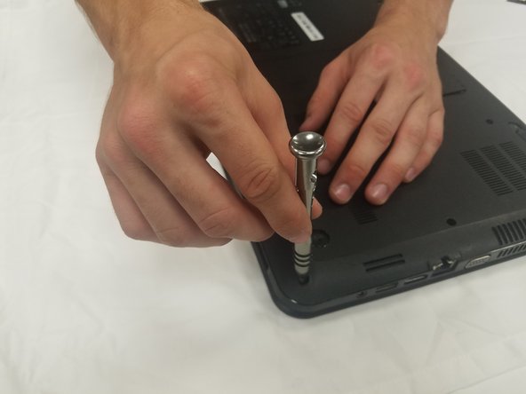

  2. HP Pavilion 15-d035dx Disk Drive Replacement, Back Panel: crwdns2935265:02crwdnd2935265:01crwdnd2935265:01crwdne2935265:0
    • Flip the laptop so that the back is facing upwards.
    • Locate the small screw on the back that holds the "L" shaped panel.
    • Using a 0 Phillip Screwdriver (4.0x4.7mm sized screw), unscrew the screw. It will not become detached from the panel but it will allow you to remove the back panel.

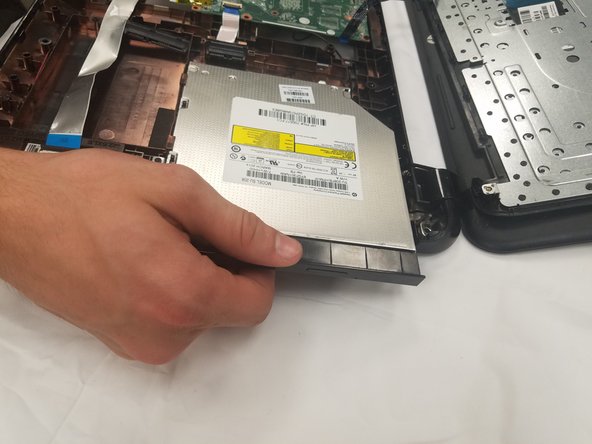

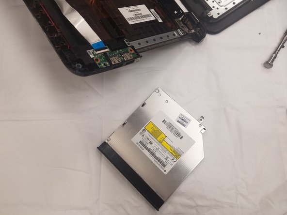

  9. HP Pavilion 15-d035dx Disk Drive Replacement: crwdns2935265:09crwdnd2935265:01crwdnd2935265:03crwdne2935265:0 HP Pavilion 15-d035dx Disk Drive Replacement: crwdns2935265:09crwdnd2935265:02crwdnd2935265:03crwdne2935265:0 HP Pavilion 15-d035dx Disk Drive Replacement: crwdns2935265:09crwdnd2935265:03crwdnd2935265:03crwdne2935265:0
    • Now you should be able slide the disk drive out to the side.
    • Do not pull up on the disk drive. This could damage the plug ins and/or the case that help holds it all together.
