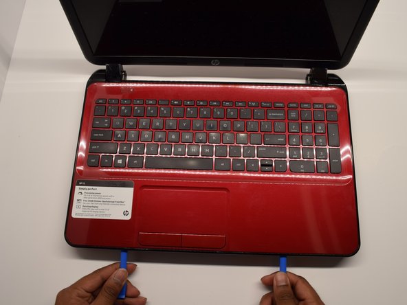

  4. HP Pavilion 15-d017cl Hard Drive Replacement: crwdns2935265:04crwdnd2935265:01crwdnd2935265:03crwdne2935265:0 HP Pavilion 15-d017cl Hard Drive Replacement: crwdns2935265:04crwdnd2935265:02crwdnd2935265:03crwdne2935265:0 HP Pavilion 15-d017cl Hard Drive Replacement: crwdns2935265:04crwdnd2935265:03crwdnd2935265:03crwdne2935265:0
    • Flip the computer over so the screen and keyboard are showing.
    • Using the opener tools, pry around the edges of the computer in between the keyboard and the base.
    • Apply enough pressure to unlatch the keyboard but be cautious of the parts under it.
    • Flip the keyboard up toward the screen to access the motherboard.

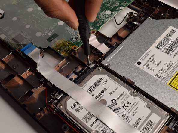

  6. HP Pavilion 15-d017cl Hard Drive Replacement: crwdns2935265:06crwdnd2935265:01crwdnd2935265:03crwdne2935265:0 HP Pavilion 15-d017cl Hard Drive Replacement: crwdns2935265:06crwdnd2935265:02crwdnd2935265:03crwdne2935265:0 HP Pavilion 15-d017cl Hard Drive Replacement: crwdns2935265:06crwdnd2935265:03crwdnd2935265:03crwdne2935265:0
    • Using a Phillips #1 screwdriver, remove the three screws located around the hard drive.
    • When finished unscrewing, pull the hard drive out.
