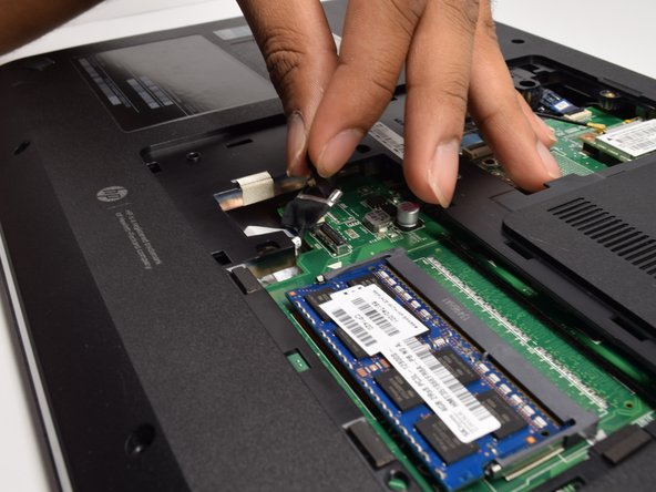

    • Using a spudger, press down on the silver latches that are holding the RAM in place. The RAM looks like a blue rectangle and has a size of about 1 x 2 inches. A slight click will be heard, and the RAM should pop out. You can then pull it away from the laptop.
    • Now that the old RAM has been removed, the new RAM can be inserted back into the laptop by pressing it gently into the place where the old RAM was.

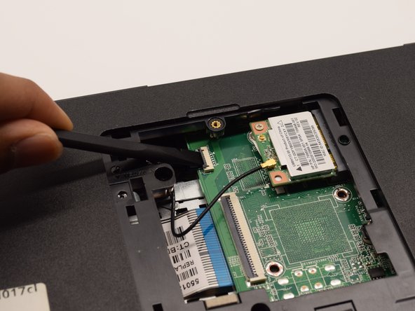

    • Remove the second attached cord at the top of the removed panel.
    • Using the Spudger, lift the latch to unlock the ribbon cable.
    • Using the Tweezers, pull the ribbon cable out of the latch.

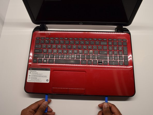

    • Flip the Computer over so the screen and keyboard are showing.
    • Using the opener tools, pry around the edges of the computer in between the keyboard and the base.
    • Apply enough pressure to unlatch the keyboard but be cautious of the parts under it.
    • Flip the keyboard up toward the screen to access the motherboard.

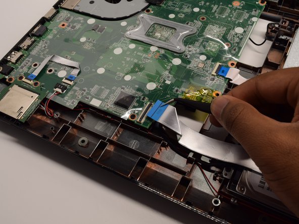

    • Remove the second Ribbon Cable to the right of the red and white cord.
    • Using the Spudger, lift up on the silver latch until the Ribbon Cable is unlocked.
    • Use the Tweezers to pull the Ribbon Cable out of the latch.

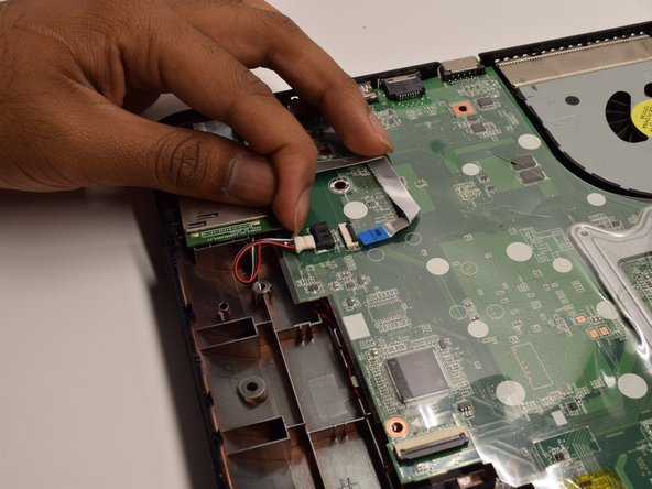

    • Using your finger, disconnect the cord from the black latch.
  15. HP Pavilion 15-d017cl Cooling Fan Replacement: crwdns2935265:015crwdnd2935265:01crwdnd2935265:02crwdne2935265:0 HP Pavilion 15-d017cl Cooling Fan Replacement: crwdns2935265:015crwdnd2935265:02crwdnd2935265:02crwdne2935265:0

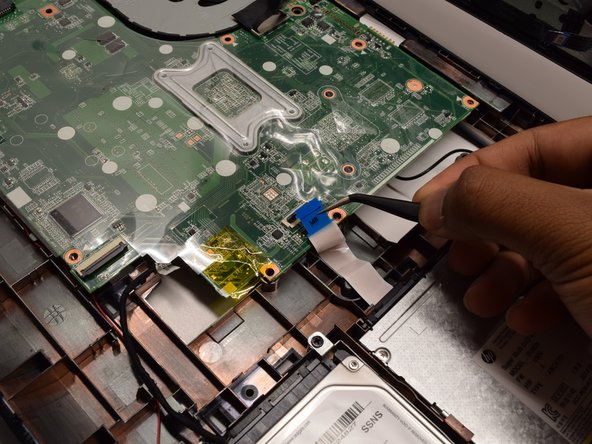

    • Using the Spudger, press into the silver latch and lift it up to unlock the latch.
    • Use the Tweezers to pull the Ribbon Cable away from the latch.

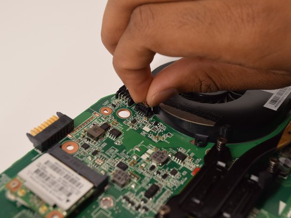

    • Remove the black tab to the right of the cooling fan.
    • Pull up on the black tab until it disconnects from the motherboard.

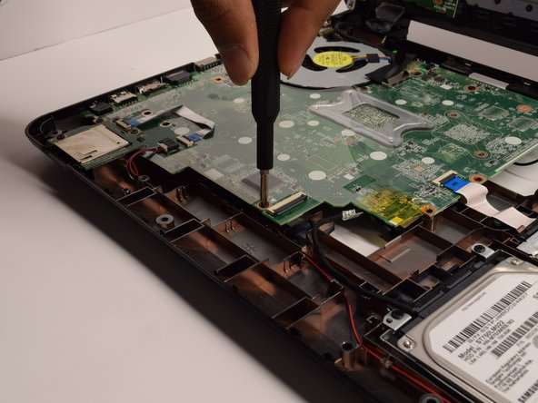

    • Remove the ten (10) 5 mm screws with the Phillips #1 Screwdriver on the Motherboard until the Motherboard loosens.

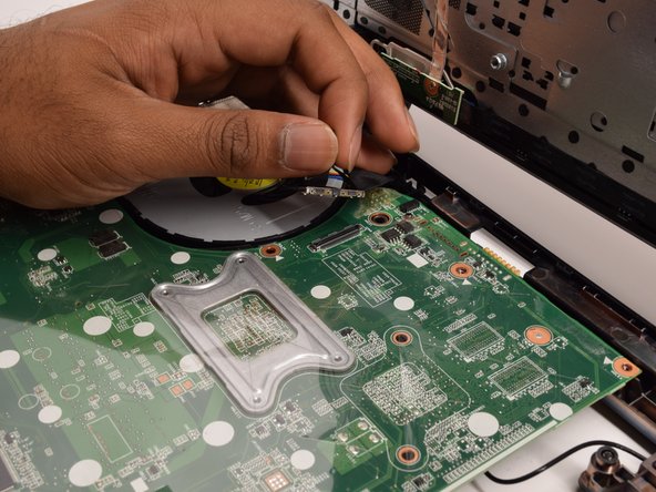

    • Remove the connected cord to the left of the cooling fan.
    • Pull the cord towards the cooling fan removing it from the black latch.

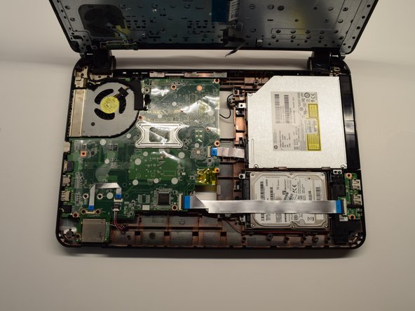

  20. HP Pavilion 15-d017cl Cooling Fan Replacement: crwdns2935265:020crwdnd2935265:01crwdnd2935265:01crwdne2935265:0
    • The Motherboard is now removed from the computer and can be replaced.

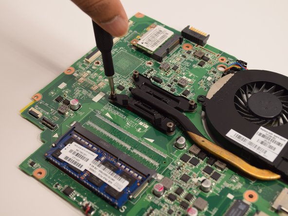

    • Remove the four 7 mm screws holding the heat sink to the motherboard with a Phillips #1 screwdriver.

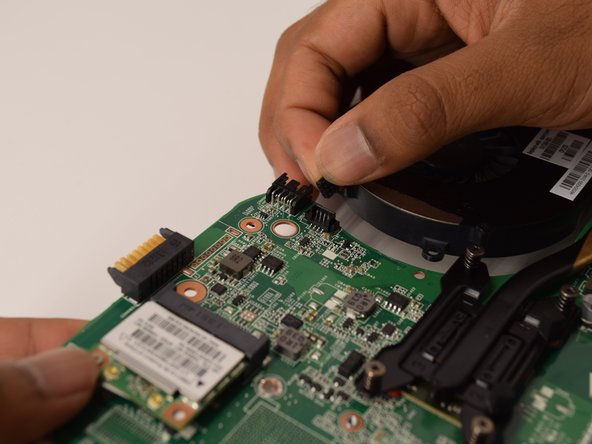

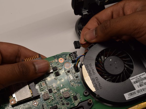

    • Firmly remove the cable connection between the cooling fan and the motherboard with your fingers.
    • Do not grab the plug by the wires.
  23. HP Pavilion 15-d017cl Cooling Fan Replacement: crwdns2935265:023crwdnd2935265:01crwdnd2935265:01crwdne2935265:0
    • Remove the fan from the motherboard.
