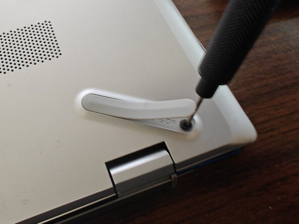

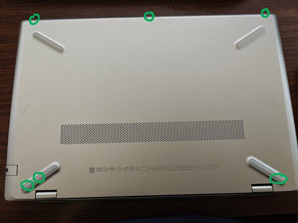

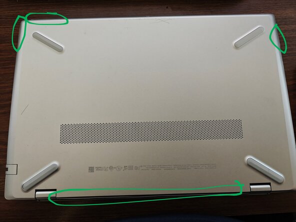

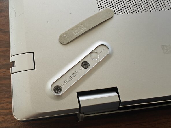

  2. HP Pavilion 15-cs3065cl WiFi Module Upgrade/Replacement, Remove screws: crwdns2935265:02crwdnd2935265:01crwdnd2935265:03crwdne2935265:0 HP Pavilion 15-cs3065cl WiFi Module Upgrade/Replacement, Remove screws: crwdns2935265:02crwdnd2935265:02crwdnd2935265:03crwdne2935265:0 HP Pavilion 15-cs3065cl WiFi Module Upgrade/Replacement, Remove screws: crwdns2935265:02crwdnd2935265:03crwdnd2935265:03crwdne2935265:0
    • There will be about 6 screws you'll need to remove.
    • You will have to at least partially remove the rubber feet to access 3 of the screws.
    • The screws are really tiny, so I recommend putting them in a Tupperware or Ziploc if you don't have a magnetic screw tray.

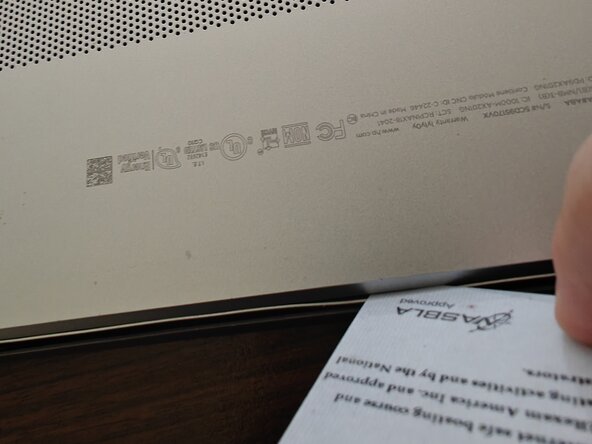

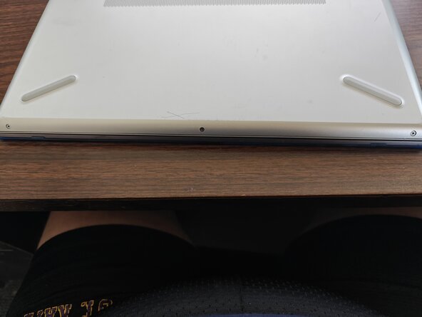

  3. HP Pavilion 15-cs3065cl WiFi Module Upgrade/Replacement, Credit Card or Pry Tool: crwdns2935265:03crwdnd2935265:01crwdnd2935265:02crwdne2935265:0 HP Pavilion 15-cs3065cl WiFi Module Upgrade/Replacement, Credit Card or Pry Tool: crwdns2935265:03crwdnd2935265:02crwdnd2935265:02crwdne2935265:0
    • You'll use a credit card, ID card, or pry tool to separate the bottom of the laptop from the rest of it. Make sure it's plastic, not metal.
    • You might want to use multiple to hold sections open as you work your way around.
  4. HP Pavilion 15-cs3065cl WiFi Module Upgrade/Replacement, Pop That Sucker Off: crwdns2935265:04crwdnd2935265:01crwdnd2935265:01crwdne2935265:0
    • You remove the bottom to reveal the guts.

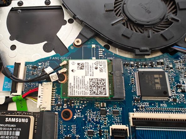

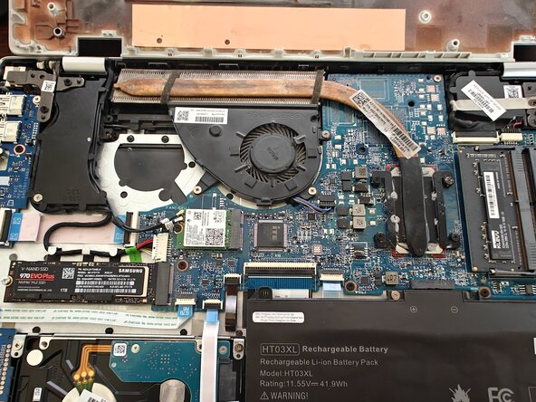

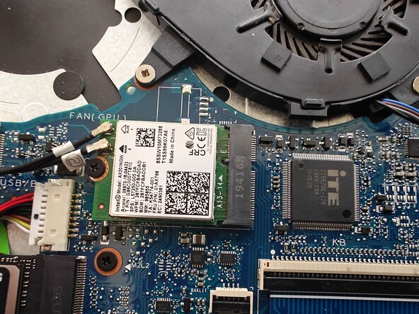

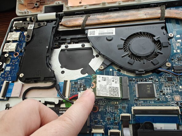

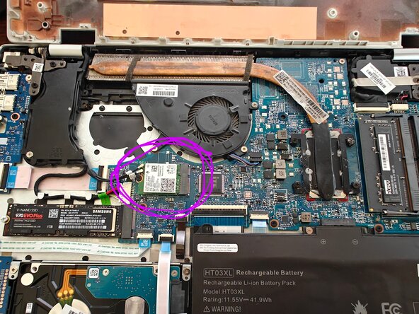

  5. HP Pavilion 15-cs3065cl WiFi Module Upgrade/Replacement, Where's Waldo?: crwdns2935265:05crwdnd2935265:01crwdnd2935265:02crwdne2935265:0 HP Pavilion 15-cs3065cl WiFi Module Upgrade/Replacement, Where's Waldo?: crwdns2935265:05crwdnd2935265:02crwdnd2935265:02crwdne2935265:0
    • Find the WiFi module.

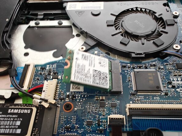

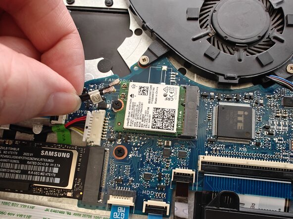

  6. HP Pavilion 15-cs3065cl WiFi Module Upgrade/Replacement, Unplugging: crwdns2935265:06crwdnd2935265:01crwdnd2935265:01crwdne2935265:0
    • Detach the antenna cables.

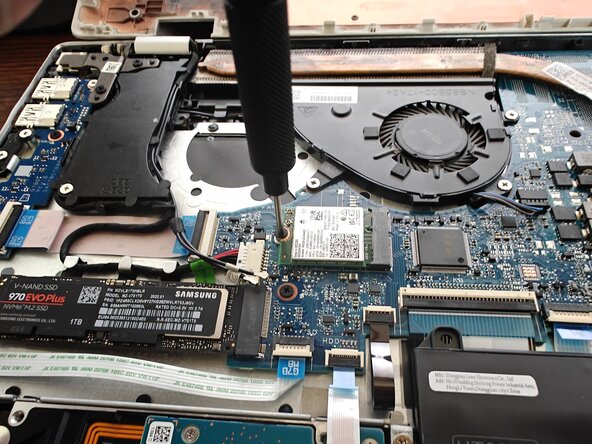

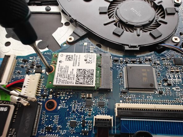

  7. HP Pavilion 15-cs3065cl WiFi Module Upgrade/Replacement, Unscrew the Module: crwdns2935265:07crwdnd2935265:01crwdnd2935265:02crwdne2935265:0 HP Pavilion 15-cs3065cl WiFi Module Upgrade/Replacement, Unscrew the Module: crwdns2935265:07crwdnd2935265:02crwdnd2935265:02crwdne2935265:0
    • Unscrew the screw.
    • It will pop up once it's unscrewed. That's normal.

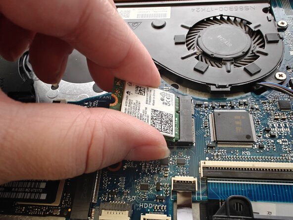

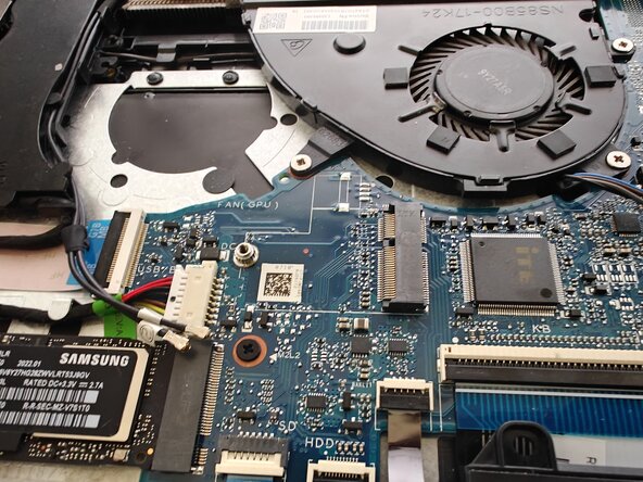

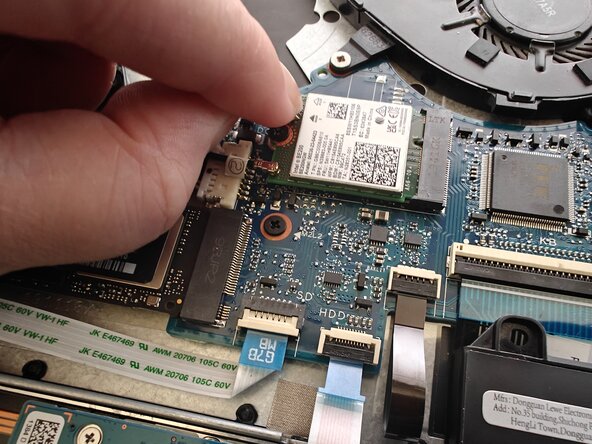

  8. HP Pavilion 15-cs3065cl WiFi Module Upgrade/Replacement, Yoink: crwdns2935265:08crwdnd2935265:01crwdnd2935265:02crwdne2935265:0 HP Pavilion 15-cs3065cl WiFi Module Upgrade/Replacement, Yoink: crwdns2935265:08crwdnd2935265:02crwdnd2935265:02crwdne2935265:0
    • Pull the module out.

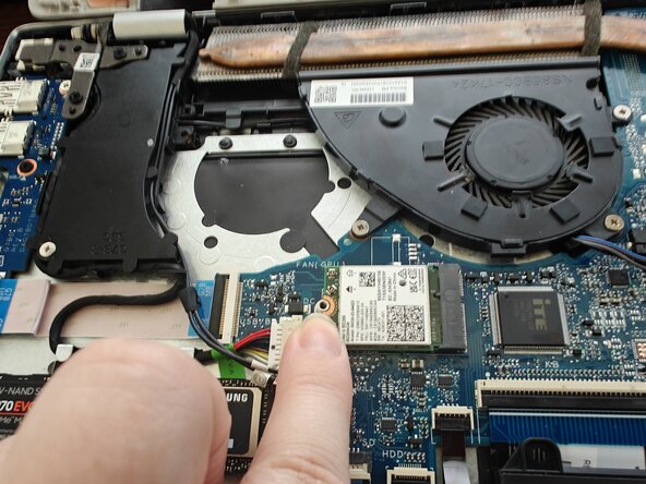

  9. HP Pavilion 15-cs3065cl WiFi Module Upgrade/Replacement, Put in the New Module: crwdns2935265:09crwdnd2935265:01crwdnd2935265:01crwdne2935265:0
    • Put in the new module.
    • You might need to push the end to get it to seat.
  10. HP Pavilion 15-cs3065cl WiFi Module Upgrade/Replacement, Screw it in: crwdns2935265:010crwdnd2935265:01crwdnd2935265:02crwdne2935265:0 HP Pavilion 15-cs3065cl WiFi Module Upgrade/Replacement, Screw it in: crwdns2935265:010crwdnd2935265:02crwdnd2935265:02crwdne2935265:0
    • Push it flat and screw it in.

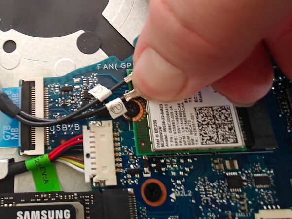

  11. HP Pavilion 15-cs3065cl WiFi Module Upgrade/Replacement, Reattach Cables: crwdns2935265:011crwdnd2935265:01crwdnd2935265:03crwdne2935265:0 HP Pavilion 15-cs3065cl WiFi Module Upgrade/Replacement, Reattach Cables: crwdns2935265:011crwdnd2935265:02crwdnd2935265:03crwdne2935265:0 HP Pavilion 15-cs3065cl WiFi Module Upgrade/Replacement, Reattach Cables: crwdns2935265:011crwdnd2935265:03crwdnd2935265:03crwdne2935265:0
    • Reattach the antenna cables.
    • They should have labels "1" and "2" on the cables. Attach them to the points labeled "1" and "2" on your new WiFi module.
    • They're teeny-tiny snap buttons, like miniature versions of what you'd find on a jacket.
    • Make sure they snap on properly, you might need to use your thumbnail. You can give them a gentle tug to make sure they're actually attached.

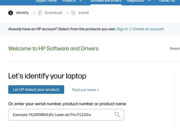

  13. HP Pavilion 15-cs3065cl WiFi Module Upgrade/Replacement, Drivers (Software): crwdns2935265:013crwdnd2935265:01crwdnd2935265:01crwdne2935265:0
    • Go to this link and install the WiFi and Bluetooth drivers that Intel recommends.
    • Power cycle your laptop (off and on again).
    • That's it, you're good to go!
