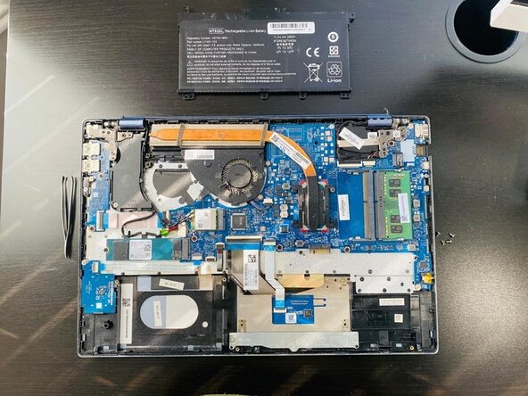

    • Ensure the laptop is completely powered off before proceeding. Holding the power button for 10-15 seconds can help drain any residual power.
    • Unplug the power adapter, remove all connected peripherals (USB drives, external monitors, etc.), and place the laptop on a clean, static-free surface to avoid dust and static damage.
    • If available, wear an anti-static wrist strap to prevent electrostatic discharge (ESD) from damaging internal components.
    • If you don’t have an anti-static wrist strap, touch a metal surface before handling internal components to discharge static electricity.
    • Keep the power adapter and other accessories in a safe place so you can reconnect them later.

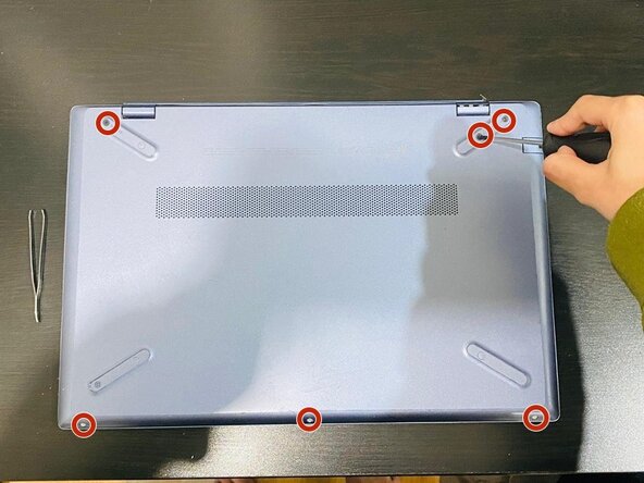

  2. HP Pavilion 15-cs3003ca Cooling Fan Replacement: crwdns2935265:02crwdnd2935265:01crwdnd2935265:02crwdne2935265:0 HP Pavilion 15-cs3003ca Cooling Fan Replacement: crwdns2935265:02crwdnd2935265:02crwdnd2935265:02crwdne2935265:0

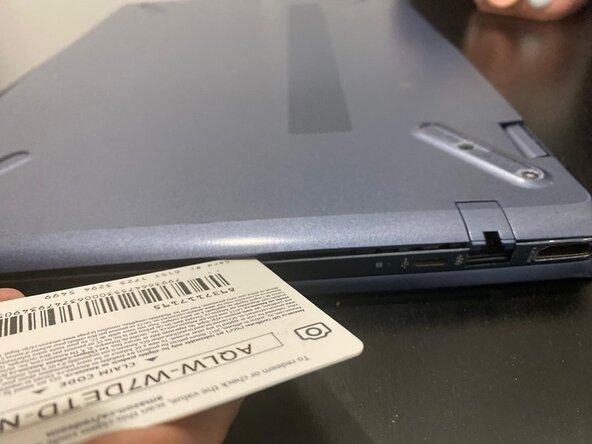

    • Flip the laptop over so the bottom panel is facing up.
    • Use a Phillips #0 screwdriver to remove six 3.2 mm screws securing the back panel.
    • If your model has rubber feet, use tweezers to carefully lift them and reveal hidden screws underneath.
    • Insert a plastic card or opening tool along the edges of the back panel.
    • Gently slide the opening tool around the edges to release the clips.
    • Do not apply excessive force when prying, as plastic clips can break.
    • Once loosened, carefully lift the panel off and set it aside.
  3. HP Pavilion 15-cs3003ca Cooling Fan Replacement: crwdns2935265:03crwdnd2935265:01crwdnd2935265:03crwdne2935265:0 HP Pavilion 15-cs3003ca Cooling Fan Replacement: crwdns2935265:03crwdnd2935265:02crwdnd2935265:03crwdne2935265:0 HP Pavilion 15-cs3003ca Cooling Fan Replacement: crwdns2935265:03crwdnd2935265:03crwdnd2935265:03crwdne2935265:0

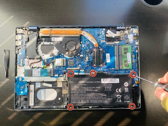

    • Use a Phillips #0 screwdriver to remove the five screws securing the battery to the laptop.
    • Gently lift the battery approximately 7 mm from the bottom edge, then slide it out of its connector on the motherboard.
    • Never use metal tools to pry the battery connector, as this could cause a short circuit or damage the connector pins.

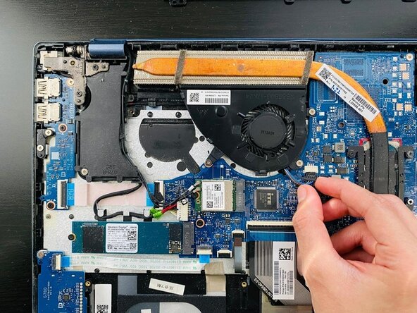

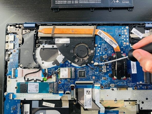

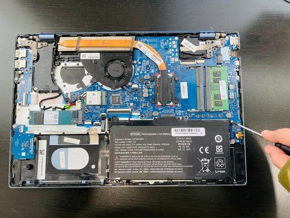

  4. HP Pavilion 15-cs3003ca Cooling Fan Replacement: crwdns2935265:04crwdnd2935265:01crwdnd2935265:02crwdne2935265:0 HP Pavilion 15-cs3003ca Cooling Fan Replacement: crwdns2935265:04crwdnd2935265:02crwdnd2935265:02crwdne2935265:0
    • Use the point of a spudger to push on alternating sides of the fan connector to "walk" it out of its socket.
    • It may take a lot of alternating before the connector comes out. Be patient, and don't pull on the cables.
    • The fan connector is delicate. Do not pull on the wires, as this may damage them or the connector.

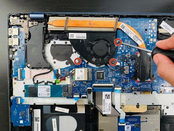

  5. HP Pavilion 15-cs3003ca Cooling Fan Replacement: crwdns2935265:05crwdnd2935265:01crwdnd2935265:03crwdne2935265:0 HP Pavilion 15-cs3003ca Cooling Fan Replacement: crwdns2935265:05crwdnd2935265:02crwdnd2935265:03crwdne2935265:0 HP Pavilion 15-cs3003ca Cooling Fan Replacement: crwdns2935265:05crwdnd2935265:03crwdnd2935265:03crwdne2935265:0

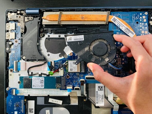

    • Use a Phillips #0 screwdriver to remove three 2.5 mm screws that secure the fan to the board.
    • Carefully remove the fan and set it aside to clean the area if necessary.
    • Do not tilt or shake the fan excessively, as dust and debris inside may spread onto other components.
    • If you notice excessive dust in the cooling system, use compressed air to clean the area before installing the new fan.

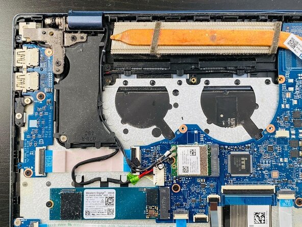

  6. HP Pavilion 15-cs3003ca Cooling Fan Replacement: crwdns2935265:06crwdnd2935265:01crwdnd2935265:03crwdne2935265:0 HP Pavilion 15-cs3003ca Cooling Fan Replacement: crwdns2935265:06crwdnd2935265:02crwdnd2935265:03crwdne2935265:0 HP Pavilion 15-cs3003ca Cooling Fan Replacement: crwdns2935265:06crwdnd2935265:03crwdnd2935265:03crwdne2935265:0
    • Carefully replace the fan without bending or pinching any cables.
    • Use a Phillips #0 screwdriver to secure the three 2.5 mm screws.
    • Ensure the fan is aligned correctly before tightening the screws. Over-tightening may cause damage to the fan or mounting points.
    • To reconnect the cable, align the connector and use a spudger or clean fingernail to push it fully into the socket.
    • Don't push on the cables themselves, or you may damage the connector.
  7. HP Pavilion 15-cs3003ca Cooling Fan Replacement: crwdns2935265:07crwdnd2935265:01crwdnd2935265:03crwdne2935265:0 HP Pavilion 15-cs3003ca Cooling Fan Replacement: crwdns2935265:07crwdnd2935265:02crwdnd2935265:03crwdne2935265:0 HP Pavilion 15-cs3003ca Cooling Fan Replacement: crwdns2935265:07crwdnd2935265:03crwdnd2935265:03crwdne2935265:0
    • Slide the battery back in so it plugs into the connector on the motherboard and secure the screws.
    • Replace the back panel and press it down gently around the edges to ensure the clips attach properly.
    • Use the Phillips #0 screwdriver to secure the six 3.2 mm screws.
    • Power on the laptop and listen for the fan running properly. Check system temperatures using software like HWMonitor or Core Temp to confirm that the cooling fan is working effectively.
