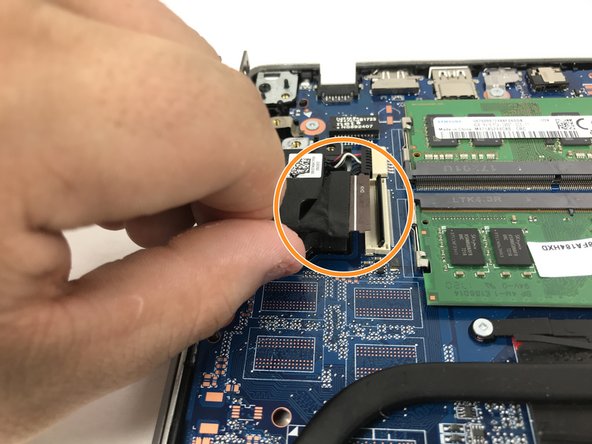

  7. HP Pavilion 15-cd040wm Screen Replacement: crwdns2935265:07crwdnd2935265:01crwdnd2935265:03crwdne2935265:0 HP Pavilion 15-cd040wm Screen Replacement: crwdns2935265:07crwdnd2935265:02crwdnd2935265:03crwdne2935265:0 HP Pavilion 15-cd040wm Screen Replacement: crwdns2935265:07crwdnd2935265:03crwdnd2935265:03crwdne2935265:0
    • Using the spudger or opening tool, remove the ribbon that connects to the screen.
    • Gently pull the ribbon out of the port after using the spudger to lift the supporter up.
    • Carefully remove the two antenna wires that connect to the screen as well. Do this by gently pulling them free from their connectors at the wifi card.
  8. HP Pavilion 15-cd040wm Screen Replacement: crwdns2935265:08crwdnd2935265:01crwdnd2935265:01crwdne2935265:0
    • Once these steps are completed, you may lift the display assembly free from the rest of the device.
