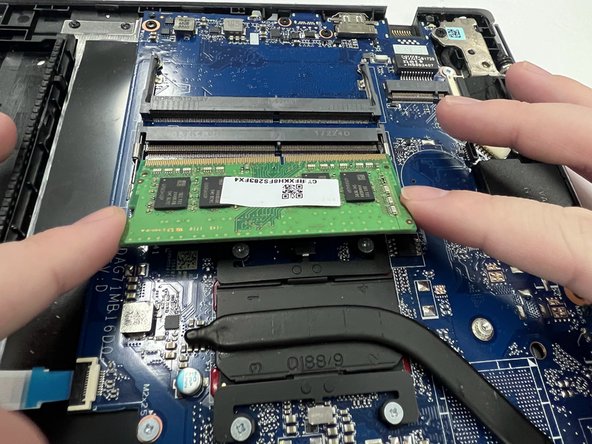

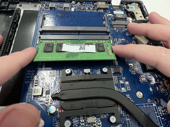

  8. HP Pavilion 15-cc561st RAM Replacement, RAM: crwdns2935265:08crwdnd2935265:01crwdnd2935265:03crwdne2935265:0 HP Pavilion 15-cc561st RAM Replacement, RAM: crwdns2935265:08crwdnd2935265:02crwdnd2935265:03crwdne2935265:0 HP Pavilion 15-cc561st RAM Replacement, RAM: crwdns2935265:08crwdnd2935265:03crwdnd2935265:03crwdne2935265:0
    • Simultaneously spread the retaining tabs on each side of the memory module slot.
    • Releasing the tabs will cause the memory module to "pop" up (the edge of the module opposite the slot rises up).
    • Pull the memory module away from the slot at the angle it rises from.
    • Line up the notch on a new memory module with the slot. This notch is designed to prevent incorrect insertion.
    • If only one memory module is installed, it must be installed in the socket that is closer to the center of the computer.
