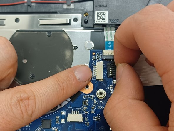

  24. HP Pavilion 15-cc561st Keyboard Assembly Replacement: crwdns2935265:024crwdnd2935265:01crwdnd2935265:03crwdne2935265:0 HP Pavilion 15-cc561st Keyboard Assembly Replacement: crwdns2935265:024crwdnd2935265:02crwdnd2935265:03crwdne2935265:0 HP Pavilion 15-cc561st Keyboard Assembly Replacement: crwdns2935265:024crwdnd2935265:03crwdnd2935265:03crwdne2935265:0

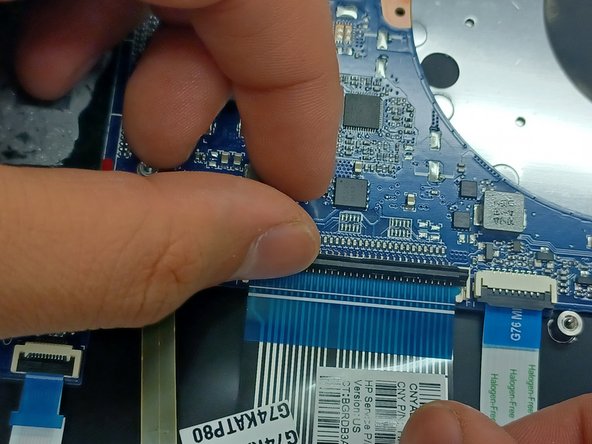

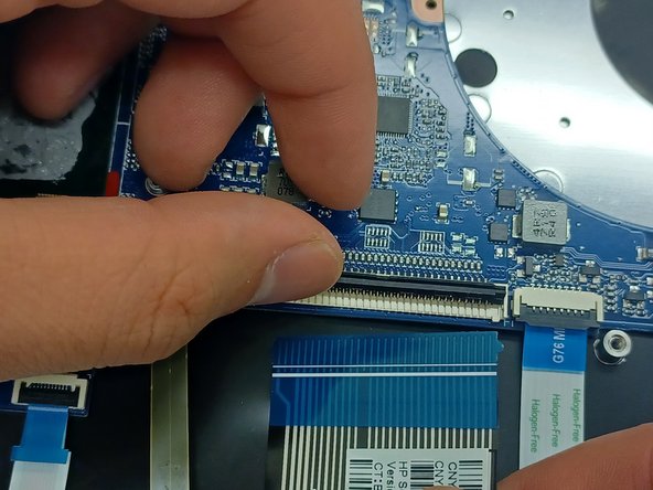

    • To remove the ZIF ribbons, pull up on the tab and gently pull away from the connector. Repeat for all 6 ZIF ribbons shown.

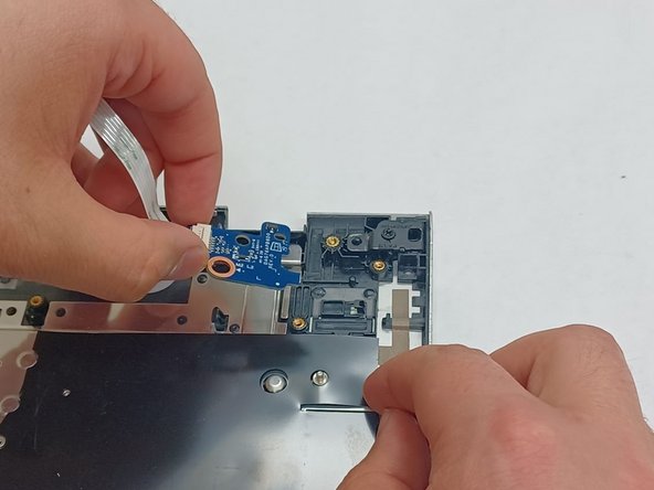

    • Use a Phillips #00 screwdriver to remove the 2.22 mm silver screw that secures the power button PCB.
    • Lift to remove the power button PCB.

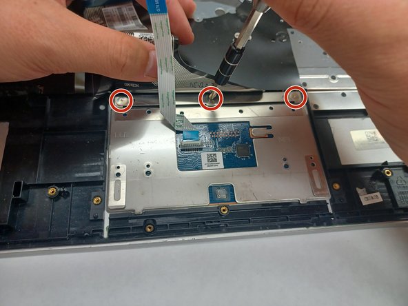

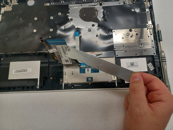

    • Use a Phillips #1 screwdriver remove the three 2.8 mm screws from the touchpad bracket.
    • Remove the touchpad bracket.

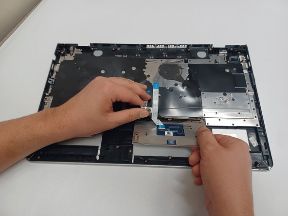

    • Lift up the keyboard ZIF Ribbon to reveal the 3 screws holding in the trackpad.
    • Remove the three 2.3 mm screws using a #1 Phillips Screwdriver.
    • Lift up on the trackpad to remove it.
    • You may need to push on the trackpad from the front of the keyboard assembly
    • What remains is the keyboard assembly to be replaced.
