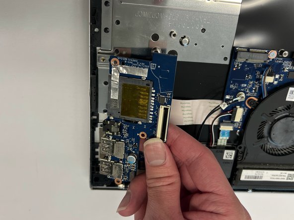

  8. HP Pavilion 15-cc561st I/O Board Replacement, I/O Board: crwdns2935265:08crwdnd2935265:01crwdnd2935265:03crwdne2935265:0 HP Pavilion 15-cc561st I/O Board Replacement, I/O Board: crwdns2935265:08crwdnd2935265:02crwdnd2935265:03crwdne2935265:0 HP Pavilion 15-cc561st I/O Board Replacement, I/O Board: crwdns2935265:08crwdnd2935265:03crwdnd2935265:03crwdne2935265:0
    • Gently release the slider of the ZIF connector that the USB port board is connected to.
    • Gently lift the Flat Flexible Cable away from the ZIF connector to disconnect the cable from the USB port board.
  9. HP Pavilion 15-cc561st I/O Board Replacement: crwdns2935265:09crwdnd2935265:01crwdnd2935265:01crwdne2935265:0
    • Use a Phillips #0 screwdriver to remove the two 5.8 mm screws that secure the USB port board.
  10. HP Pavilion 15-cc561st I/O Board Replacement: crwdns2935265:010crwdnd2935265:01crwdnd2935265:02crwdne2935265:0 HP Pavilion 15-cc561st I/O Board Replacement: crwdns2935265:010crwdnd2935265:02crwdnd2935265:02crwdne2935265:0
    • Lift the USB port board upwards to remove it.
