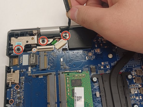

    • Remove a total of five 6.65 mm Phillips-head screws with Philips #00 screw driver.

    • To separate the display assembly from the keyboard assembly, rotate the display hinges away from the motherboard.
    • You may need to pry apart the hinges with the display assembly by turning the computer around and pulling keyboard assembly towards yourself while holding the display assembly to the table.

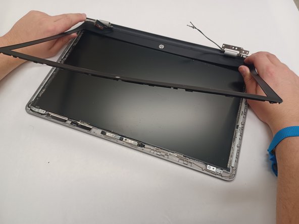

    • Use the black plastic spudger to pry the screen frame from the LCD display
    • Repeat all around the frame until you can pull the screen frame off of the display asembly.

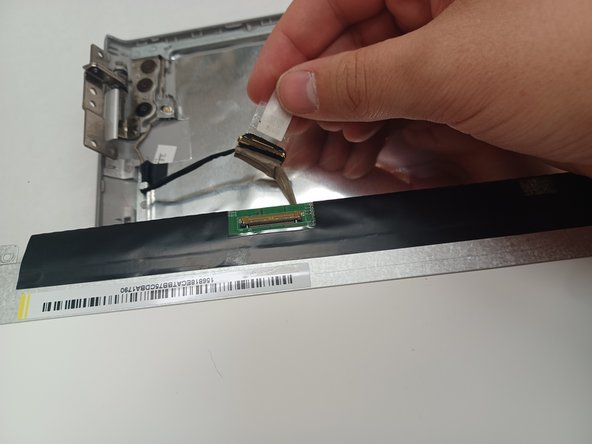

  16. HP Pavilion 15-cc561st Display Replacement: crwdns2935265:016crwdnd2935265:01crwdnd2935265:02crwdne2935265:0 HP Pavilion 15-cc561st Display Replacement: crwdns2935265:016crwdnd2935265:02crwdnd2935265:02crwdne2935265:0
    • Unplug the display cable connector by removing the display sticker and gently pulling it away from the terminal.
