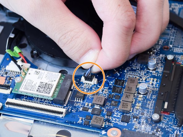

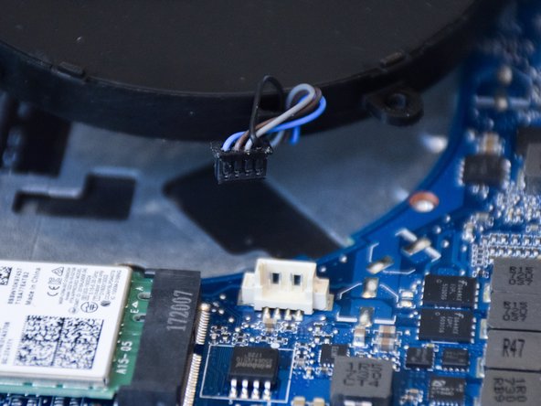

    • Remove the three screws securing the fan to the motherboard using the Phillips #0 screwdriver.
    • Unplug the cables that run from the fan to the motherboard and remove the fan.

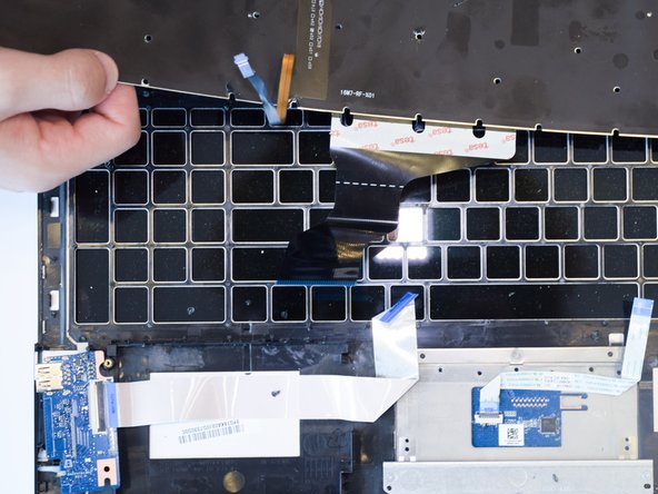

  14. HP Pavilion 15-cc123cl Keyboard Replacement: crwdns2935265:014crwdnd2935265:01crwdnd2935265:02crwdne2935265:0 HP Pavilion 15-cc123cl Keyboard Replacement: crwdns2935265:014crwdnd2935265:02crwdnd2935265:02crwdne2935265:0
    • Grab the corner of the keyboard, then lift and remove the keyboard from the computer.
