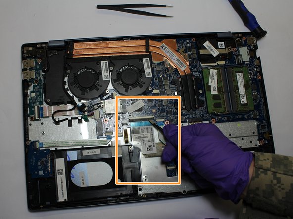

    • Once the battery is removed, use the tweezers to disconnect the smaller ribbon cable that is attached to the touchpad and motherboard.
    • Proceed to disconnect the larger ribbon cable that is attached to the touchpad and motherboard.

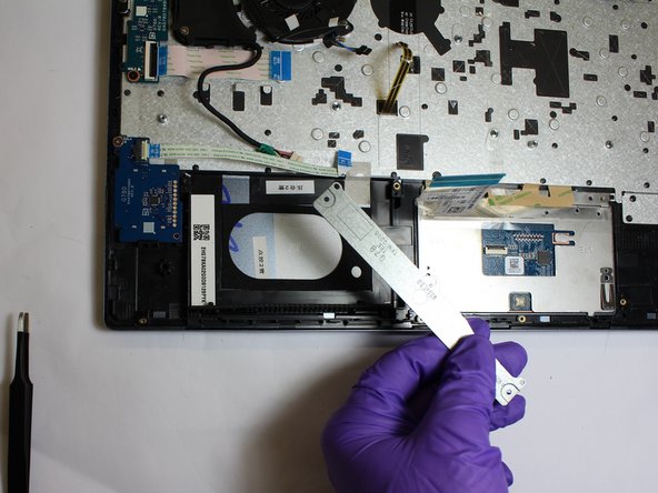

    • Using a screwdriver with a Phillips #00 screwdriver, remove the three screws on the metal touchpad bracket. Remove the bracket.
  6. HP Pavilion 15-ca2073cl Touchpad Replacement: crwdns2935265:06crwdnd2935265:01crwdnd2935265:01crwdne2935265:0
    • Using the tweezers, pull back the adhesive tape at the top of the touchpad.
    • Using the screwdriver with a Phillips #00 screwdriver, remove the two screws at the top of the touchpad.
  7. HP Pavilion 15-ca2073cl Touchpad Replacement: crwdns2935265:07crwdnd2935265:01crwdnd2935265:01crwdne2935265:0
    • Gently remove the touchpad from the laptop.
