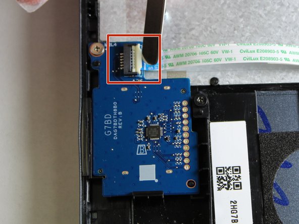

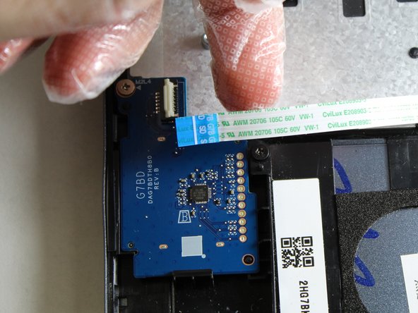

    • Use a spudger to flip up the retaining flap securing the ribbon cable
    • Remove the white ribbon cable from its connector.
  5. HP Pavilion 15-ca2073cl SD Card Reader Replacement: crwdns2935265:05crwdnd2935265:01crwdnd2935265:01crwdne2935265:0
    • Remove the single silver 4.3 mm screw with a Phillips #0 screwdriver.
  6. HP Pavilion 15-ca2073cl SD Card Reader Replacement: crwdns2935265:06crwdnd2935265:01crwdnd2935265:01crwdne2935265:0
    • Remove the SD card reader from the laptop.
