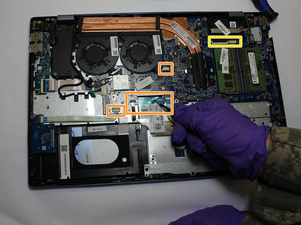

  4. HP Pavilion 15-ca2073cl Motherboard  Replacement, Motherboard: crwdns2935265:04crwdnd2935265:01crwdnd2935265:02crwdne2935265:0 HP Pavilion 15-ca2073cl Motherboard  Replacement, Motherboard: crwdns2935265:04crwdnd2935265:02crwdnd2935265:02crwdne2935265:0
    • Remove the screws surrounding the motherboard using the Phillips #00 screwdriver.
    • Dismount the power supply ribbon cable by lifting the cable lock and pulling the cable with the flat-tipped tweezers.
    • Gently remove and disconnect the two display ribbon cables located at the top right corner of the moother board.
    • Disconnect the keyboard cable next to the power supply cable.
    • Disconnect the disc and hard drive cables.
