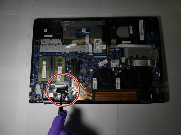

  5. HP Pavilion 15-ca2073cl Display-Pad Replacement: crwdns2935265:05crwdnd2935265:01crwdnd2935265:02crwdne2935265:0 HP Pavilion 15-ca2073cl Display-Pad Replacement: crwdns2935265:05crwdnd2935265:02crwdnd2935265:02crwdne2935265:0
    • Remove the screws from the display to the frame of the laptop.
    • Remove the cables that connect to the motherboard.

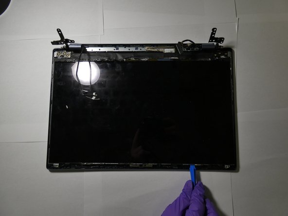

  6. HP Pavilion 15-ca2073cl Display-Pad Replacement: crwdns2935265:06crwdnd2935265:01crwdnd2935265:01crwdne2935265:0
    • Gently remove the display from the rest of the laptop.
  7. HP Pavilion 15-ca2073cl Display-Pad Replacement: crwdns2935265:07crwdnd2935265:01crwdnd2935265:01crwdne2935265:0
    • Using a spudger, remove the cover from the display pad.
  8. HP Pavilion 15-ca2073cl Display-Pad Replacement: crwdns2935265:08crwdnd2935265:01crwdnd2935265:02crwdne2935265:0 HP Pavilion 15-ca2073cl Display-Pad Replacement: crwdns2935265:08crwdnd2935265:02crwdnd2935265:02crwdne2935265:0
    • Remove the screws surrounding the display.
    • Using the spudger, pry the display from the display pad.
