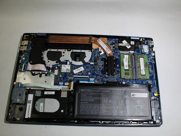

  3. HP Pavilion 15-ca2073cl Cooling Fan Replacement, Battery: crwdns2935265:03crwdnd2935265:01crwdnd2935265:02crwdne2935265:0 HP Pavilion 15-ca2073cl Cooling Fan Replacement, Battery: crwdns2935265:03crwdnd2935265:02crwdnd2935265:02crwdne2935265:0
    • Remove six 4.8mm screws (silver) using the Phillips #00 screwdriver.

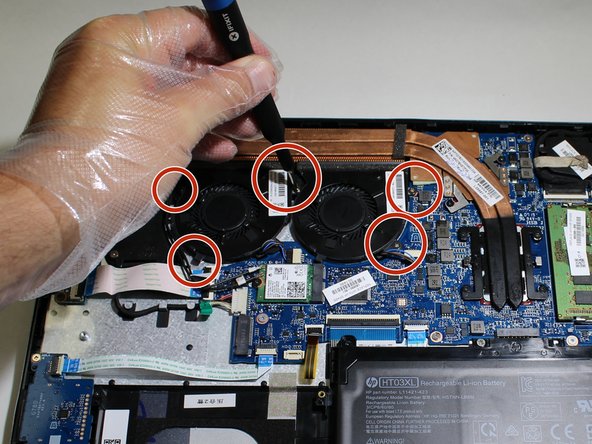

    • Remove the five silver 4.3 mm screws securing the fans using a Phillips #0 screwdriver.
  5. HP Pavilion 15-ca2073cl Cooling Fan Replacement: crwdns2935265:05crwdnd2935265:01crwdnd2935265:02crwdne2935265:0 HP Pavilion 15-ca2073cl Cooling Fan Replacement: crwdns2935265:05crwdnd2935265:02crwdnd2935265:02crwdne2935265:0

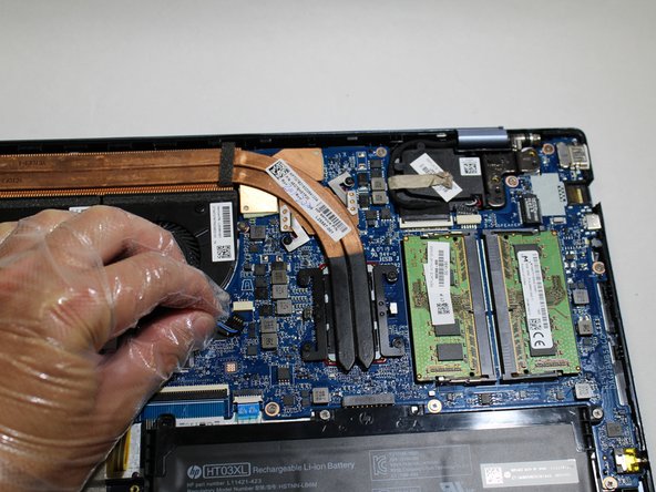

    • Remove the two cables from their connectors on the motherboard.

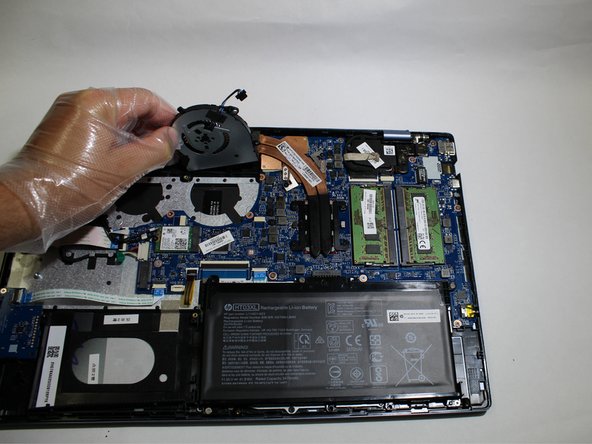

    • Lift and remove one cooling fan at a time from the laptop.
