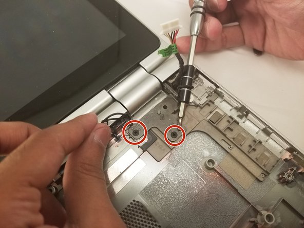

  9. HP Pavilion 15-bk020wm Touchscreen Replacement: crwdns2935265:09crwdnd2935265:01crwdnd2935265:02crwdne2935265:0 HP Pavilion 15-bk020wm Touchscreen Replacement: crwdns2935265:09crwdnd2935265:02crwdnd2935265:02crwdne2935265:0
    • Unscrew the screen from the laptop body using Phillips 00. Screw size: M2.5x4.4
  10. HP Pavilion 15-bk020wm Touchscreen Replacement: crwdns2935265:010crwdnd2935265:01crwdnd2935265:01crwdne2935265:0
    • Lift the touchscreen hinges using the plastic opening tool to detach the screen.
    • Obtain the new touchscreen to connect to your device.
