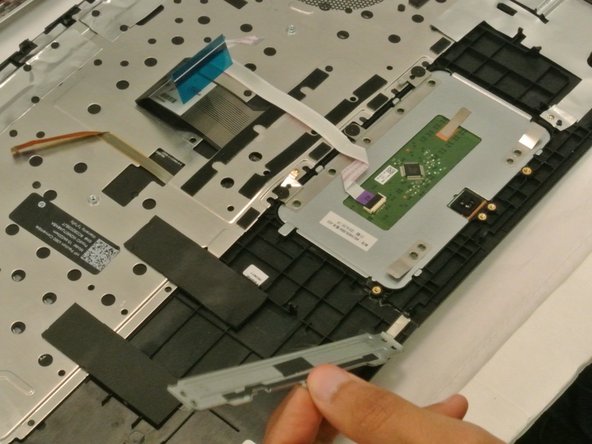

    • After taking the keyboard cover off of the device, flip it over and locate the purple and white cable.
    • Using the plastic opening tool, flip the ZIF connector open and detach the touchpad cable.
  5. HP Pavilion 15-bk020wm Touchpad Replacement: crwdns2935265:05crwdnd2935265:01crwdnd2935265:03crwdne2935265:0 HP Pavilion 15-bk020wm Touchpad Replacement: crwdns2935265:05crwdnd2935265:02crwdnd2935265:03crwdne2935265:0 HP Pavilion 15-bk020wm Touchpad Replacement: crwdns2935265:05crwdnd2935265:03crwdnd2935265:03crwdne2935265:0

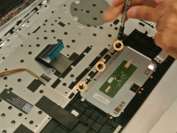

    • Unscrew the three screws at the bottom of the touchpad using the #00 Phillips screwdriver.
    • Life the bottom security piece off of the touchpad.
    • Unscrew the three top screws using the same #00 Phillips screwdriver.
  6. HP Pavilion 15-bk020wm Touchpad Replacement: crwdns2935265:06crwdnd2935265:01crwdnd2935265:01crwdne2935265:0
    • Using the plastic opening tool, lift the touchpad off of the keyboard cover.
