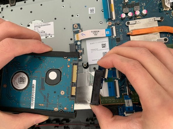

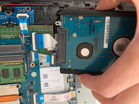

  5. HP Pavilion 15-ba003ds Hard Drive Replacement, Backplate: crwdns2935265:05crwdnd2935265:01crwdnd2935265:03crwdne2935265:0 HP Pavilion 15-ba003ds Hard Drive Replacement, Backplate: crwdns2935265:05crwdnd2935265:02crwdnd2935265:03crwdne2935265:0 HP Pavilion 15-ba003ds Hard Drive Replacement, Backplate: crwdns2935265:05crwdnd2935265:03crwdnd2935265:03crwdne2935265:0
    • Use a Jimmy to pry off the black backplate.
  6. HP Pavilion 15-ba003ds Hard Drive Replacement, Hard Drive: crwdns2935265:06crwdnd2935265:01crwdnd2935265:03crwdne2935265:0 HP Pavilion 15-ba003ds Hard Drive Replacement, Hard Drive: crwdns2935265:06crwdnd2935265:02crwdnd2935265:03crwdne2935265:0 HP Pavilion 15-ba003ds Hard Drive Replacement, Hard Drive: crwdns2935265:06crwdnd2935265:03crwdnd2935265:03crwdne2935265:0
    • Remove the data connector from the hard drive.
