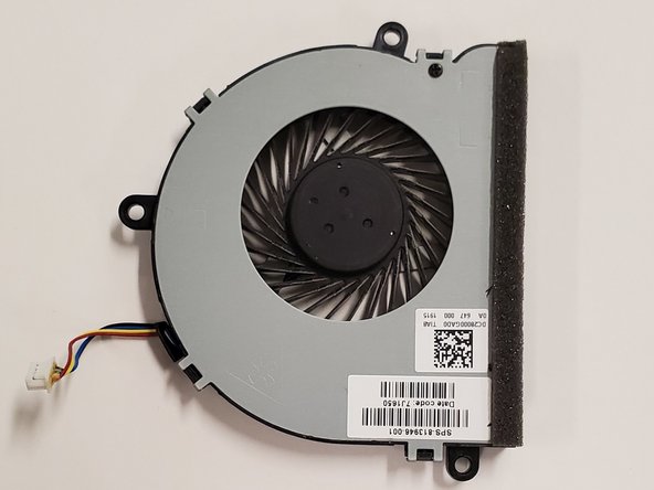

  3. HP Pavilion 15-ba003ds Charging Port Replacement, Cooling Fan: crwdns2935265:03crwdnd2935265:01crwdnd2935265:02crwdne2935265:0 HP Pavilion 15-ba003ds Charging Port Replacement, Cooling Fan: crwdns2935265:03crwdnd2935265:02crwdnd2935265:02crwdne2935265:0
    • Remove three black 6mm Phillips #00 screws.
  4. HP Pavilion 15-ba003ds Charging Port Replacement: crwdns2935265:04crwdnd2935265:01crwdnd2935265:03crwdne2935265:0 HP Pavilion 15-ba003ds Charging Port Replacement: crwdns2935265:04crwdnd2935265:02crwdnd2935265:03crwdne2935265:0 HP Pavilion 15-ba003ds Charging Port Replacement: crwdns2935265:04crwdnd2935265:03crwdnd2935265:03crwdne2935265:0
    • Unplug the white connector using your fingers or a spudger.
  5. HP Pavilion 15-ba003ds Charging Port Replacement: crwdns2935265:05crwdnd2935265:01crwdnd2935265:03crwdne2935265:0 HP Pavilion 15-ba003ds Charging Port Replacement: crwdns2935265:05crwdnd2935265:02crwdnd2935265:03crwdne2935265:0 HP Pavilion 15-ba003ds Charging Port Replacement: crwdns2935265:05crwdnd2935265:03crwdnd2935265:03crwdne2935265:0
    • Pull out the fan by hand.

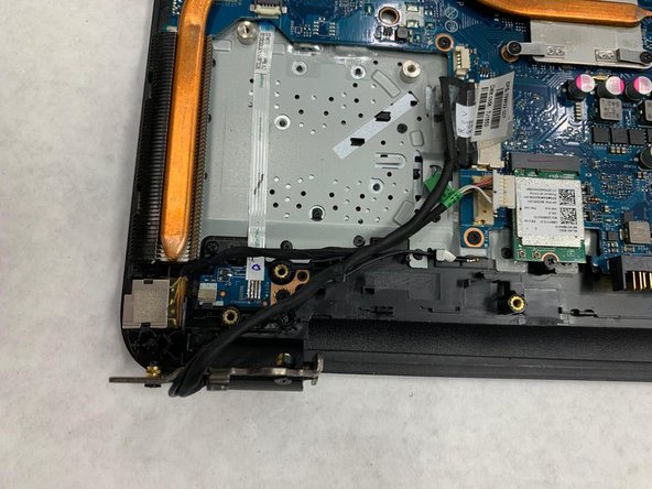

  6. HP Pavilion 15-ba003ds Charging Port Replacement, Charging Port: crwdns2935265:06crwdnd2935265:01crwdnd2935265:01crwdne2935265:0
    • Use a spudger to disconnect the power cable from the motherboard.

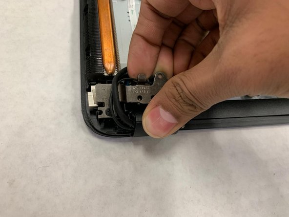

  7. HP Pavilion 15-ba003ds Charging Port Replacement: crwdns2935265:07crwdnd2935265:01crwdnd2935265:03crwdne2935265:0 HP Pavilion 15-ba003ds Charging Port Replacement: crwdns2935265:07crwdnd2935265:02crwdnd2935265:03crwdne2935265:0 HP Pavilion 15-ba003ds Charging Port Replacement: crwdns2935265:07crwdnd2935265:03crwdnd2935265:03crwdne2935265:0
    • Remove two 8mm Phillips #2 screws from the metal plate.
    • Use your hand to flip the metal plate so you can see the charging port fully.
  8. HP Pavilion 15-ba003ds Charging Port Replacement: crwdns2935265:08crwdnd2935265:01crwdnd2935265:02crwdne2935265:0 HP Pavilion 15-ba003ds Charging Port Replacement: crwdns2935265:08crwdnd2935265:02crwdnd2935265:02crwdne2935265:0
    • Use a spudger to pry off the charging port.
