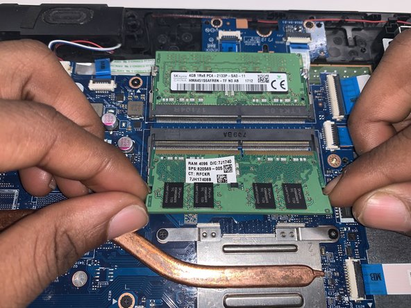

  7. HP Pavilion 15-ay041wm RAM Replacement, RAM: crwdns2935265:07crwdnd2935265:01crwdnd2935265:03crwdne2935265:0 HP Pavilion 15-ay041wm RAM Replacement, RAM: crwdns2935265:07crwdnd2935265:02crwdnd2935265:03crwdne2935265:0 HP Pavilion 15-ay041wm RAM Replacement, RAM: crwdns2935265:07crwdnd2935265:03crwdnd2935265:03crwdne2935265:0
    • Orient the base of the laptop with the base facing away from you.
    • With you index finger and thumb, position your thumb underneath both latches on either side of the RAM and squeeze outwards.
    • Simultaneously, use your index finger to push the RAM sticks towards you.
    • The RAM stick will release and pop up and out.
  8. HP Pavilion 15-ay041wm RAM Replacement: crwdns2935265:08crwdnd2935265:01crwdnd2935265:02crwdne2935265:0 HP Pavilion 15-ay041wm RAM Replacement: crwdns2935265:08crwdnd2935265:02crwdnd2935265:02crwdne2935265:0
    • Repeat the same process for the top RAM stick.
    • The RAM stick will release and pop up. Pull the RAM stick out to remove it from the laptop.
