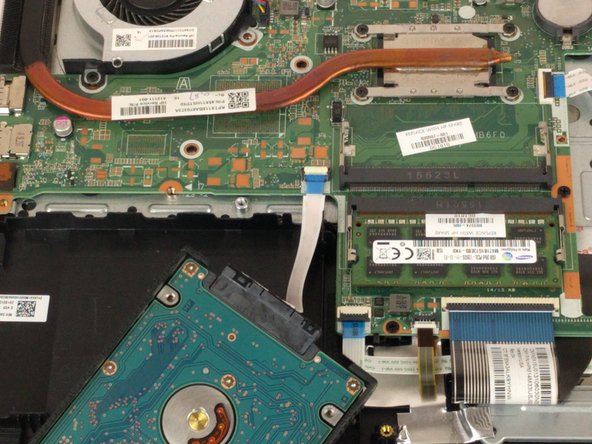

  9. HP Pavilion 15-ab243cl Hard Drive Replacement, Hard Drive: crwdns2935265:09crwdnd2935265:01crwdnd2935265:03crwdne2935265:0 HP Pavilion 15-ab243cl Hard Drive Replacement, Hard Drive: crwdns2935265:09crwdnd2935265:02crwdnd2935265:03crwdne2935265:0 HP Pavilion 15-ab243cl Hard Drive Replacement, Hard Drive: crwdns2935265:09crwdnd2935265:03crwdnd2935265:03crwdne2935265:0
    • Locate the hard drive and lift up to give better access to the connector.

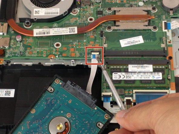

  10. HP Pavilion 15-ab243cl Hard Drive Replacement: crwdns2935265:010crwdnd2935265:01crwdnd2935265:03crwdne2935265:0 HP Pavilion 15-ab243cl Hard Drive Replacement: crwdns2935265:010crwdnd2935265:02crwdnd2935265:03crwdne2935265:0 HP Pavilion 15-ab243cl Hard Drive Replacement: crwdns2935265:010crwdnd2935265:03crwdnd2935265:03crwdne2935265:0
    • Using a plastic opening tool or spudger, pry open the white tab to release connector.
  11. HP Pavilion 15-ab243cl Hard Drive Replacement: crwdns2935265:011crwdnd2935265:01crwdnd2935265:02crwdne2935265:0 HP Pavilion 15-ab243cl Hard Drive Replacement: crwdns2935265:011crwdnd2935265:02crwdnd2935265:02crwdne2935265:0
    • Hard drive is good to go and can now be removed.
