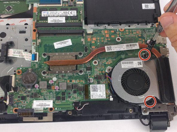

  9. HP Pavilion 15-ab243cl Cooling Fan Replacement, Cooling Fan: crwdns2935265:09crwdnd2935265:01crwdnd2935265:03crwdne2935265:0 HP Pavilion 15-ab243cl Cooling Fan Replacement, Cooling Fan: crwdns2935265:09crwdnd2935265:02crwdnd2935265:03crwdne2935265:0 HP Pavilion 15-ab243cl Cooling Fan Replacement, Cooling Fan: crwdns2935265:09crwdnd2935265:03crwdnd2935265:03crwdne2935265:0
    • Use a PH00 screw driver to remove the two 3.5 mm screws holding the fan in place.
    • Careful with the lower screw, there are two screws side by side. The screw to the left side of the device is the one you want and is connected to fan, the one on the right side is not for fan.

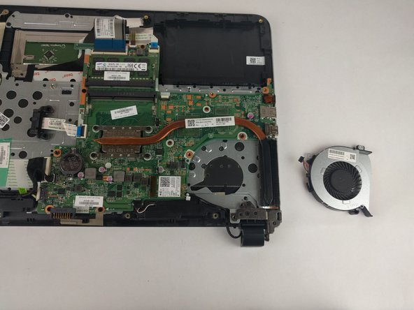

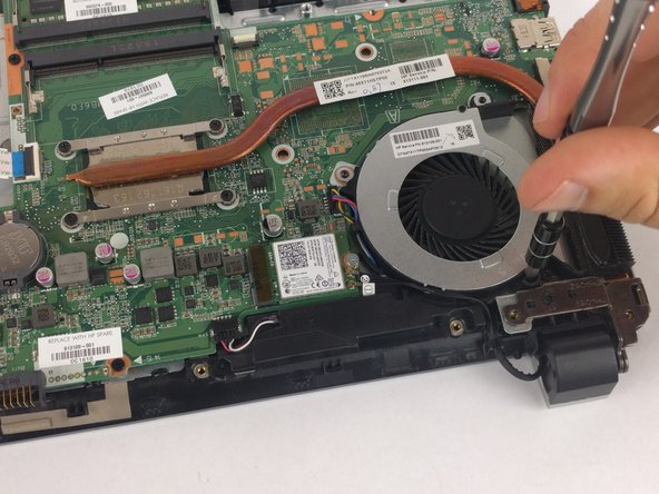

  10. HP Pavilion 15-ab243cl Cooling Fan Replacement: crwdns2935265:010crwdnd2935265:01crwdnd2935265:03crwdne2935265:0 HP Pavilion 15-ab243cl Cooling Fan Replacement: crwdns2935265:010crwdnd2935265:02crwdnd2935265:03crwdne2935265:0 HP Pavilion 15-ab243cl Cooling Fan Replacement: crwdns2935265:010crwdnd2935265:03crwdnd2935265:03crwdne2935265:0
    • Use long nose tweezers to remove connector. Fan will lift out.
