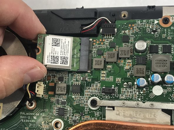

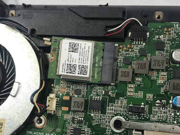

  15. HP Pavilion 15-AB153NR WiFi Card Replacement, WiFi Card: crwdns2935265:015crwdnd2935265:01crwdnd2935265:02crwdne2935265:0 HP Pavilion 15-AB153NR WiFi Card Replacement, WiFi Card: crwdns2935265:015crwdnd2935265:02crwdnd2935265:02crwdne2935265:0
    • Disconnect the antenna cable from the terminals on the card.
  16. HP Pavilion 15-AB153NR WiFi Card Replacement: crwdns2935265:016crwdnd2935265:01crwdnd2935265:03crwdne2935265:0 HP Pavilion 15-AB153NR WiFi Card Replacement: crwdns2935265:016crwdnd2935265:02crwdnd2935265:03crwdne2935265:0 HP Pavilion 15-AB153NR WiFi Card Replacement: crwdns2935265:016crwdnd2935265:03crwdnd2935265:03crwdne2935265:0
    • Using Phillips #0 screwdriver, remove the 3mm screw that connects the card to the motherboard.
    • The Wi-Fi card should pop up after screw is removed.
    • Use sliding motion to disconnect other side.
  17. HP Pavilion 15-AB153NR WiFi Card Replacement: crwdns2935265:017crwdnd2935265:01crwdnd2935265:01crwdne2935265:0
    • To remove the card, pull it away from the slot at an angle.
