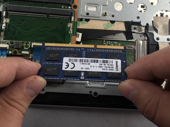

  15. HP Pavilion 15-AB153NR RAM Replacement, RAM: crwdns2935265:015crwdnd2935265:01crwdnd2935265:01crwdne2935265:0
    • Spread retaining tabs on each side of the RAM slot to release.
    • RAM should automatically tilt up.
  16. HP Pavilion 15-AB153NR RAM Replacement: crwdns2935265:016crwdnd2935265:01crwdnd2935265:02crwdne2935265:0 HP Pavilion 15-AB153NR RAM Replacement: crwdns2935265:016crwdnd2935265:02crwdnd2935265:02crwdne2935265:0
    • Remove the RAM by pulling it away from the slot at at angle.
