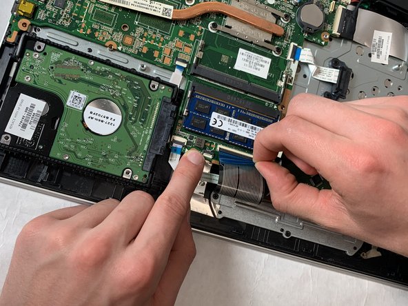

  21. HP Pavilion 15-AB153NR Motherboard Replacement, Motherboard: crwdns2935265:021crwdnd2935265:01crwdnd2935265:01crwdne2935265:0
    • Use the #000 screwdriver to remove the four 6mm screws attaching the motherboard to the laptop case.
  22. HP Pavilion 15-AB153NR Motherboard Replacement: crwdns2935265:022crwdnd2935265:01crwdnd2935265:02crwdne2935265:0 HP Pavilion 15-AB153NR Motherboard Replacement: crwdns2935265:022crwdnd2935265:02crwdnd2935265:02crwdne2935265:0
    • Never pull on the wires themselves to disconnect a wiring harness or ribbon.
    • Unclip the wiring ribbons from the motherboard by pulling up on the blue tabs.
    • Unplug the wiring harness to the screen by gently pulling the beige connector.
  23. HP Pavilion 15-AB153NR Motherboard Replacement: crwdns2935265:023crwdnd2935265:01crwdnd2935265:01crwdne2935265:0
    • Be sure to grab the motherboard by the edges. This will reduce the risk of damaging the motherboard components.
    • Remove the motherboard.
