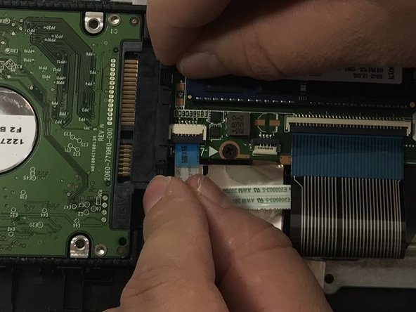

  15. HP Pavilion 15-AB153NR Hard Drive Replacement, Hard Drive: crwdns2935265:015crwdnd2935265:01crwdnd2935265:02crwdne2935265:0 HP Pavilion 15-AB153NR Hard Drive Replacement, Hard Drive: crwdns2935265:015crwdnd2935265:02crwdnd2935265:02crwdne2935265:0
    • Disconnect the hard drive cable from the motherboard by sliding it left to right.

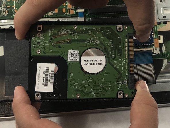

  16. HP Pavilion 15-AB153NR Hard Drive Replacement: crwdns2935265:016crwdnd2935265:01crwdnd2935265:02crwdne2935265:0 HP Pavilion 15-AB153NR Hard Drive Replacement: crwdns2935265:016crwdnd2935265:02crwdnd2935265:02crwdne2935265:0
    • Lift the hard drive from the computer.

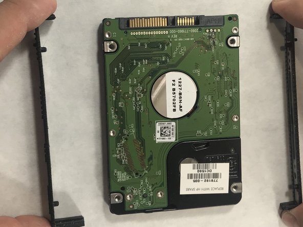

  17. HP Pavilion 15-AB153NR Hard Drive Replacement: crwdns2935265:017crwdnd2935265:01crwdnd2935265:02crwdne2935265:0 HP Pavilion 15-AB153NR Hard Drive Replacement: crwdns2935265:017crwdnd2935265:02crwdnd2935265:02crwdne2935265:0
    • Pull the brackets away from each side of the hard drive.
