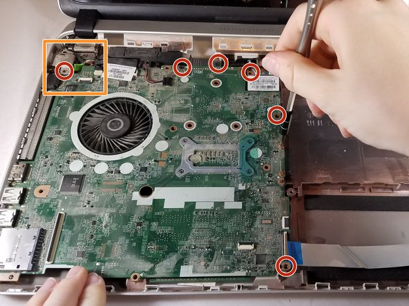

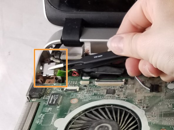

  10. HP Pavilion 14-v062us Fan Replacement, Fan: crwdns2935265:010crwdnd2935265:01crwdnd2935265:03crwdne2935265:0 HP Pavilion 14-v062us Fan Replacement, Fan: crwdns2935265:010crwdnd2935265:02crwdnd2935265:03crwdne2935265:0 HP Pavilion 14-v062us Fan Replacement, Fan: crwdns2935265:010crwdnd2935265:03crwdnd2935265:03crwdne2935265:0
    • Remove all 6 screws (5.65 mm) from the motherboard, using Phillips screwdriver J0
    • There will be a silver covering (in a z shape) that needs to be removed using black tweezers or a plastic opening tool
  11. HP Pavilion 14-v062us Fan Replacement: crwdns2935265:011crwdnd2935265:01crwdnd2935265:01crwdne2935265:0
    • Remove the two 5.66mm screws from the motherboard using Phillips head screwdriver J0
  12. HP Pavilion 14-v062us Fan Replacement: crwdns2935265:012crwdnd2935265:01crwdnd2935265:02crwdne2935265:0 HP Pavilion 14-v062us Fan Replacement: crwdns2935265:012crwdnd2935265:02crwdnd2935265:02crwdne2935265:0
    • Remove entire motherboard from the laptop
    • Turn over and remove the single 5.63mm screw using a Phillips head screwdriver J0.
