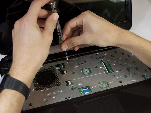

    • Locate these seven 5mm circled screws on the panel that was under the keyboard.
    • Remove the screws with a Phillips Head #1 Screwdriver.

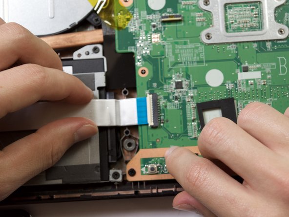

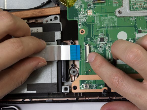

  5. HP Pavilion 14-c015dx Chromebook Headphone Jack Replacement: crwdns2935265:05crwdnd2935265:01crwdnd2935265:03crwdne2935265:0 HP Pavilion 14-c015dx Chromebook Headphone Jack Replacement: crwdns2935265:05crwdnd2935265:02crwdnd2935265:03crwdne2935265:0 HP Pavilion 14-c015dx Chromebook Headphone Jack Replacement: crwdns2935265:05crwdnd2935265:03crwdnd2935265:03crwdne2935265:0

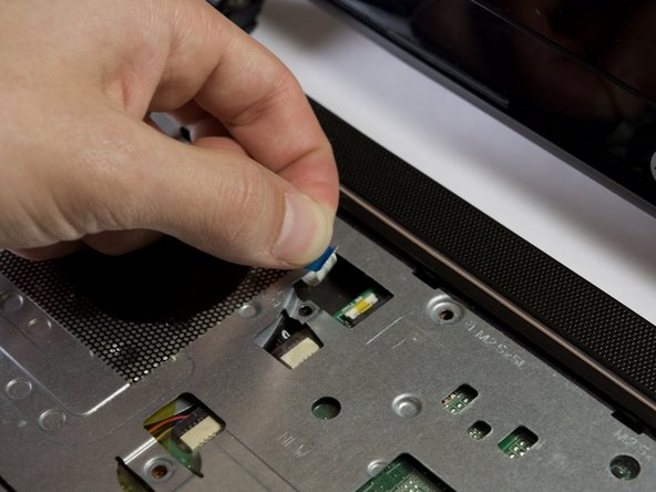

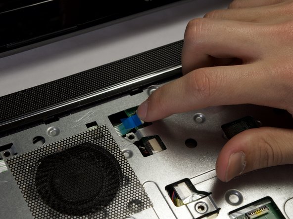

    • Locate the ribbon cable located at the top of the keyboard area.
    • At the cable base, lift the white tab with a fingernail and then gently pull on the blue tab of the cable to release it.

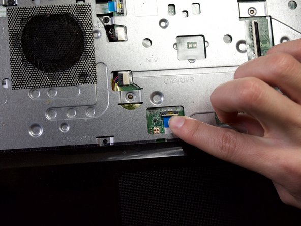

  6. HP Pavilion 14-c015dx Chromebook Headphone Jack Replacement: crwdns2935265:06crwdnd2935265:01crwdnd2935265:03crwdne2935265:0 HP Pavilion 14-c015dx Chromebook Headphone Jack Replacement: crwdns2935265:06crwdnd2935265:02crwdnd2935265:03crwdne2935265:0 HP Pavilion 14-c015dx Chromebook Headphone Jack Replacement: crwdns2935265:06crwdnd2935265:03crwdnd2935265:03crwdne2935265:0

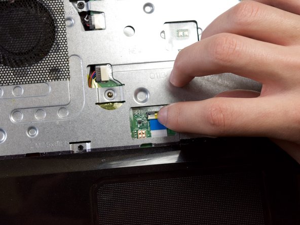

    • Locate the ribbon cable just above the touchpad.
    • Disconnect the cable by lifting the white tab at the base of the cable with a fingernail and then pulling on the blue section of the cable.

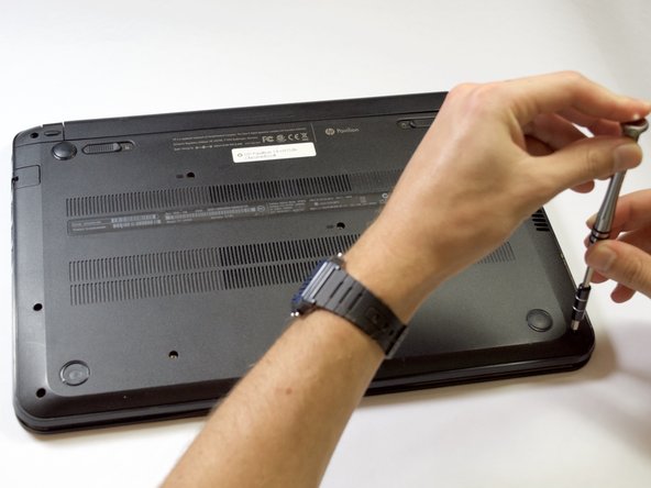

    • Locate these eight 7mm screws on the bottom of the laptop.
    • Remove using a Philips Head #1 Screwdriver.

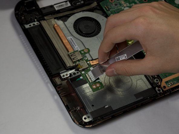

    • Flip the plastic flap to unattach the metal strip located at the bottom left corner.
    • The headphone jack is attached to this cable.

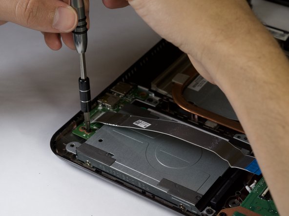

  10. HP Pavilion 14-c015dx Chromebook Headphone Jack Replacement: crwdns2935265:010crwdnd2935265:01crwdnd2935265:03crwdne2935265:0 HP Pavilion 14-c015dx Chromebook Headphone Jack Replacement: crwdns2935265:010crwdnd2935265:02crwdnd2935265:03crwdne2935265:0 HP Pavilion 14-c015dx Chromebook Headphone Jack Replacement: crwdns2935265:010crwdnd2935265:03crwdnd2935265:03crwdne2935265:0
    • Remove the circled screw located at the bottom left using a Phillips #1 Screwdriver.
    • You can now disconnect the headphone jack piece.
