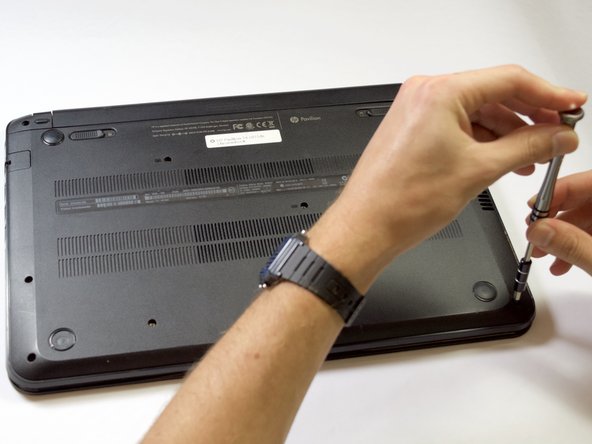

    • Remove the two 7mm screws with a Phillips Head #1 Screwdriver.
    • These screws may not completely come out of the laptop, so just make sure that you have loosened them all of the way.

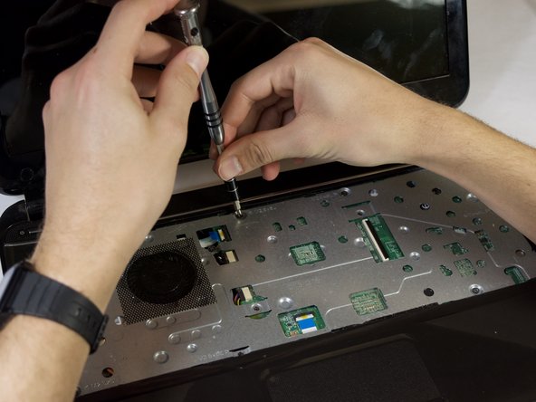

    • Locate these seven circled screws.
    • Remove the seven 5mm screws using the Phillips Head #1 Screwdriver.

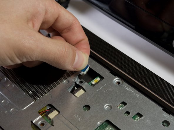

    • Locate the ribbon cable near the top of the keyboard area.
    • At the cable base, lift the white tab with a fingernail and then pull on the blue section of the cable to release it.

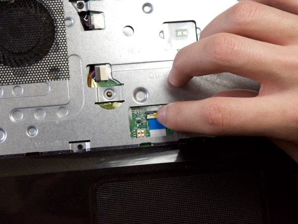

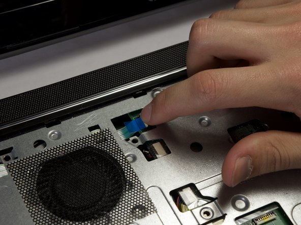

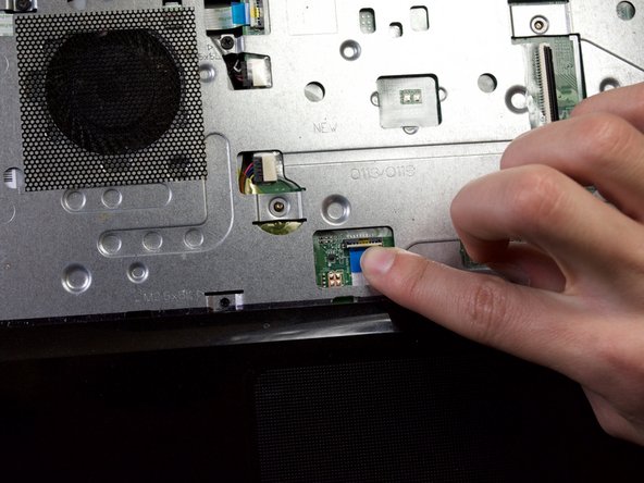

    • Locate the ribbon cable just above the touchpad.
    • Disconnect the cable by lifting the white tab at the base of the cable with a fingernail and then pulling on the blue section of the cable.

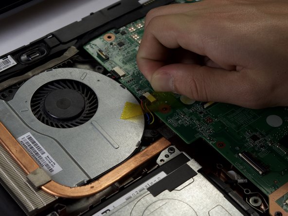

    • Locate the protective yellow tape that is covering two wires in between the fan and the motherboard.
    • Remove this yellow tape.
    • Some laptops may not have this protective yellow tape. If yours does not it does not matter, just skip this step.

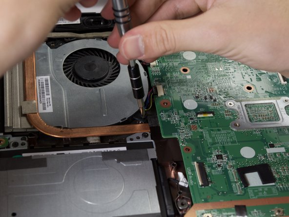

    • Locate the single remaining screw holding the fan in place.
    • Remove the 5 mm screw using a Phillips Head #1 Screw Driver.

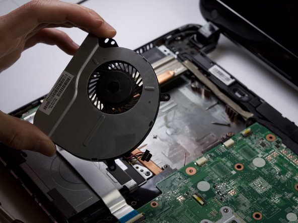

    • Locate the wires that connect the fan to the motherboard.
    • Remove this wire connector using the tweezers.
    • You can now completely remove the fan from the laptop.
