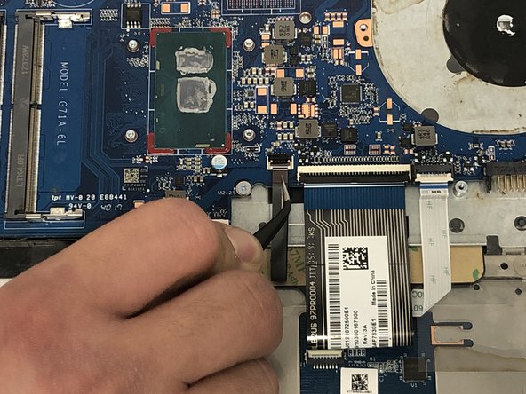

  14. HP Pavilion 14-bk061st Motherboard Replacement: crwdns2935265:014crwdnd2935265:01crwdnd2935265:02crwdne2935265:0 HP Pavilion 14-bk061st Motherboard Replacement: crwdns2935265:014crwdnd2935265:02crwdnd2935265:02crwdne2935265:0
    • Remove the nine cables from the motherboard by carefully lifting the black tab on each connector.
  15. HP Pavilion 14-bk061st Motherboard Replacement: crwdns2935265:015crwdnd2935265:01crwdnd2935265:01crwdne2935265:0
    • Carefully remove the motherboard from the casing.
