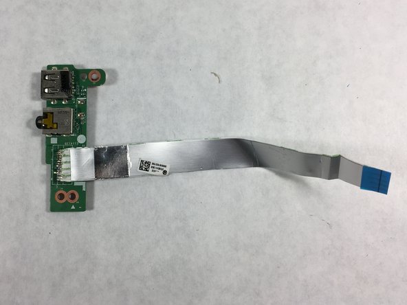

  8. HP Pavilion 14-b120dx Audio Port/USB Drive Replacement, Audio Port and USB drive: crwdns2935265:08crwdnd2935265:01crwdnd2935265:02crwdne2935265:0 HP Pavilion 14-b120dx Audio Port/USB Drive Replacement, Audio Port and USB drive: crwdns2935265:08crwdnd2935265:02crwdnd2935265:02crwdne2935265:0
    • Carefully disconnect the cable connecting the ports to the motherboard from the right side.
  9. HP Pavilion 14-b120dx Audio Port/USB Drive Replacement: crwdns2935265:09crwdnd2935265:01crwdnd2935265:03crwdne2935265:0 HP Pavilion 14-b120dx Audio Port/USB Drive Replacement: crwdns2935265:09crwdnd2935265:02crwdnd2935265:03crwdne2935265:0 HP Pavilion 14-b120dx Audio Port/USB Drive Replacement: crwdns2935265:09crwdnd2935265:03crwdnd2935265:03crwdne2935265:0
    • Remove the two 6.0 mm screws from the ports.
  10. HP Pavilion 14-b120dx Audio Port/USB Drive Replacement: crwdns2935265:010crwdnd2935265:01crwdnd2935265:02crwdne2935265:0 HP Pavilion 14-b120dx Audio Port/USB Drive Replacement: crwdns2935265:010crwdnd2935265:02crwdnd2935265:02crwdne2935265:0
    • Push the ports to the left and lift upward to remove them safely.
