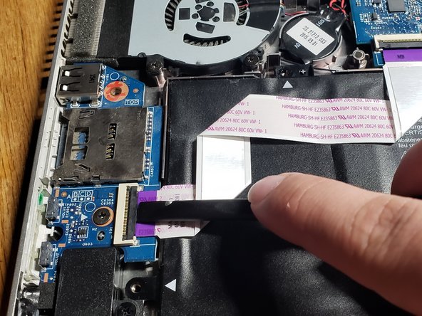

  4. HP Pavilion 13-s128nr Battery Replacement, Battery: crwdns2935265:04crwdnd2935265:01crwdnd2935265:02crwdne2935265:0 HP Pavilion 13-s128nr Battery Replacement, Battery: crwdns2935265:04crwdnd2935265:02crwdnd2935265:02crwdne2935265:0
    • Lift upwards on the black tabs the purple strip is connected to.
    • Gently pull the purple strip out of its place.
