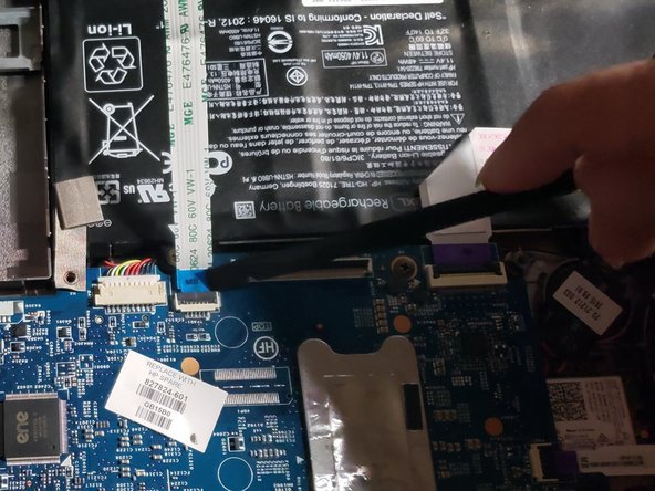

  1. HP Pavilion 13-s128nr Back Panel Replacement, Back Panel: crwdns2935265:01crwdnd2935265:01crwdnd2935265:02crwdne2935265:0 HP Pavilion 13-s128nr Back Panel Replacement, Back Panel: crwdns2935265:01crwdnd2935265:02crwdnd2935265:02crwdne2935265:0
    • Use the iFixit opening tool to take off the rubber caps.
    • Remove the screws using the Phillips #0 screwdriver.
  2. HP Pavilion 13-s128nr Back Panel Replacement: crwdns2935265:02crwdnd2935265:01crwdnd2935265:01crwdne2935265:0
    • Use the Jimmy to pry around the seam of the laptop.
    • Remove the back panel of the laptop.
    • Don't completely remove the back panel as there are ribbon cables that can be easily damaged if removed quickly.
  3. HP Pavilion 13-s128nr Back Panel Replacement: crwdns2935265:03crwdnd2935265:01crwdnd2935265:02crwdne2935265:0 HP Pavilion 13-s128nr Back Panel Replacement: crwdns2935265:03crwdnd2935265:02crwdnd2935265:02crwdne2935265:0
    • Using the iFixit opening tool to lift the tabs holding in the cables connecting the keyboard to the motherboard.
    • Pull the cable from the motherboard.
