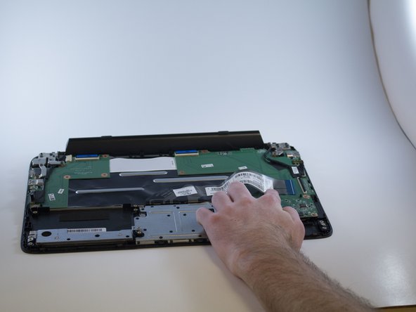

  5. HP Pavilion 13-P110NR Keyboard Replacement: crwdns2935265:05crwdnd2935265:01crwdnd2935265:02crwdne2935265:0 HP Pavilion 13-P110NR Keyboard Replacement: crwdns2935265:05crwdnd2935265:02crwdnd2935265:02crwdne2935265:0
    • Unflip the lock on the wire tape and lift that end of the tape away.
    • Do the same for the small white piece of tape on the circuit board.

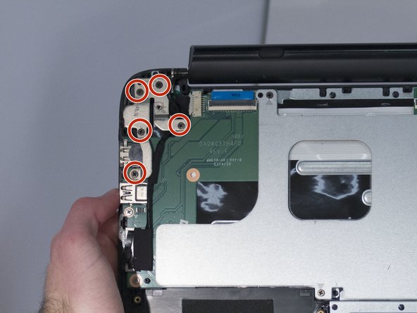

  6. HP Pavilion 13-P110NR Keyboard Replacement: crwdns2935265:06crwdnd2935265:01crwdnd2935265:02crwdne2935265:0 HP Pavilion 13-P110NR Keyboard Replacement: crwdns2935265:06crwdnd2935265:02crwdnd2935265:02crwdne2935265:0
    • Remove the eight 6.0 mm Philips #00 screws from the two silver holds.
