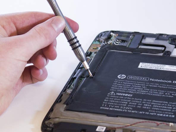

    • Unscrew the three screws from the circuit board using a Phillips #00 screwdriver.
    • Unscrew two 4.0 mm Philips #00 screws from the left side of the battery.
    • Unscrew two 3.0 mm Philips #00 screws from the right side of the battery.
