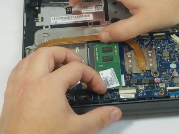

  8. HP Pavilion 11-n010dx Ram Replacement, Ram: crwdns2935265:08crwdnd2935265:01crwdnd2935265:02crwdne2935265:0 HP Pavilion 11-n010dx Ram Replacement, Ram: crwdns2935265:08crwdnd2935265:02crwdnd2935265:02crwdne2935265:0
    • Using your fingernails, pull the tabs on either side of the RAM to release the module from its secured spot.
  9. HP Pavilion 11-n010dx Ram Replacement: crwdns2935265:09crwdnd2935265:01crwdnd2935265:02crwdne2935265:0 HP Pavilion 11-n010dx Ram Replacement: crwdns2935265:09crwdnd2935265:02crwdnd2935265:02crwdne2935265:0
    • Carefully grab and pull to remove the RAM from your device.
