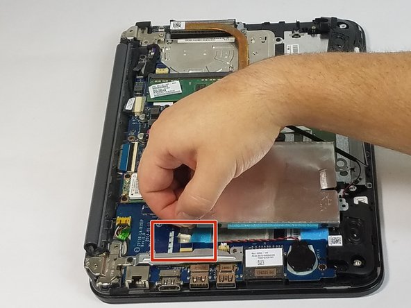

  3. HP Pavilion 11-n010dx Hard Drive Replacement: crwdns2935265:03crwdnd2935265:01crwdnd2935265:02crwdne2935265:0 HP Pavilion 11-n010dx Hard Drive Replacement: crwdns2935265:03crwdnd2935265:02crwdnd2935265:02crwdne2935265:0
    • Use the blue plastic opening tool to lift up on the white tab that is holding the cable in place on the motherboard.
    • Now carefully pull the cable out of place and remove the entire back casing.

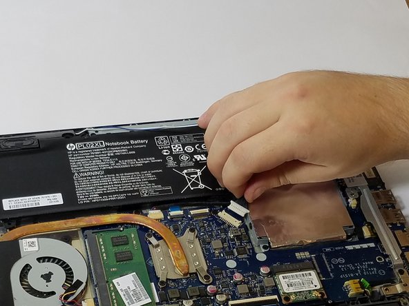

  5. HP Pavilion 11-n010dx Hard Drive Replacement: crwdns2935265:05crwdnd2935265:01crwdnd2935265:02crwdne2935265:0 HP Pavilion 11-n010dx Hard Drive Replacement: crwdns2935265:05crwdnd2935265:02crwdnd2935265:02crwdne2935265:0
    • Use the nylon spudger to pry away the blue/white wire that is positioned near your battery.
  6. HP Pavilion 11-n010dx Hard Drive Replacement: crwdns2935265:06crwdnd2935265:01crwdnd2935265:02crwdne2935265:0 HP Pavilion 11-n010dx Hard Drive Replacement: crwdns2935265:06crwdnd2935265:02crwdnd2935265:02crwdne2935265:0
    • Disconnect the battery cable from the motherboard by carefully pulling on the black wire at the point closest to the white tab.
  7. HP Pavilion 11-n010dx Hard Drive Replacement: crwdns2935265:07crwdnd2935265:01crwdnd2935265:01crwdne2935265:0
    • Remove the battery from your device.

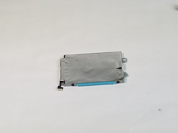

  10. HP Pavilion 11-n010dx Hard Drive Replacement: crwdns2935265:010crwdnd2935265:01crwdnd2935265:03crwdne2935265:0 HP Pavilion 11-n010dx Hard Drive Replacement: crwdns2935265:010crwdnd2935265:02crwdnd2935265:03crwdne2935265:0 HP Pavilion 11-n010dx Hard Drive Replacement: crwdns2935265:010crwdnd2935265:03crwdnd2935265:03crwdne2935265:0
    • Gently pull on the cable connector to disconnect the hard drive from your device.
