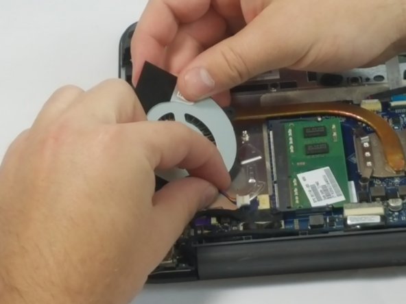

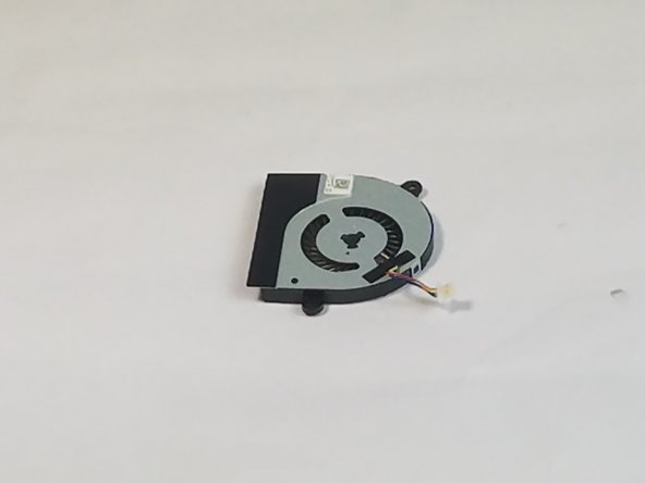

  8. HP Pavilion 11-n010dx Fan Replacement, Fan: crwdns2935265:08crwdnd2935265:01crwdnd2935265:01crwdne2935265:0
    • Use the Phillips #0 to remove the two 3mm screws holding the fan in place.
  9. HP Pavilion 11-n010dx Fan Replacement: crwdns2935265:09crwdnd2935265:01crwdnd2935265:03crwdne2935265:0 HP Pavilion 11-n010dx Fan Replacement: crwdns2935265:09crwdnd2935265:02crwdnd2935265:03crwdne2935265:0 HP Pavilion 11-n010dx Fan Replacement: crwdns2935265:09crwdnd2935265:03crwdnd2935265:03crwdne2935265:0
    • Use the plastic opening tool to slowly loosen the connection cable.
    • Once the connector is loose enough, grab the cable and carefully pull it free from your device.
