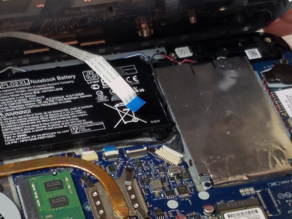

    • Use the nylon spudger to pry the back casing near the hinges for the screen.
    • Continue to pry along the edge of the back case until the back is ready to be removed.
    • Careful when beginning to remove the case. There is a cable attached between the bottom case and the motherboard that must be properly disconnected.
  3. HP Pavilion 11-n010dx Bottom Case Replacement: crwdns2935265:03crwdnd2935265:01crwdnd2935265:02crwdne2935265:0 HP Pavilion 11-n010dx Bottom Case Replacement: crwdns2935265:03crwdnd2935265:02crwdnd2935265:02crwdne2935265:0
    • Use the plastic opening tool to lift up on the white tab that is holding the cable in place on the motherboard.
    • Now carefully pull the cable out of place and remove the entire back casing.
