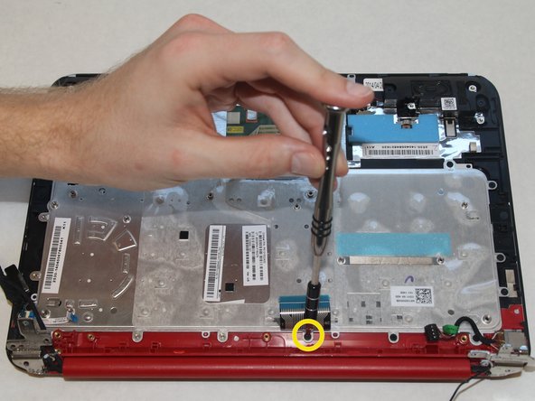

  26. HP Pavilion 11 x360 Keyboard Replacement, Detach Keyboard: crwdns2935265:026crwdnd2935265:01crwdnd2935265:02crwdne2935265:0 HP Pavilion 11 x360 Keyboard Replacement, Detach Keyboard: crwdns2935265:026crwdnd2935265:02crwdnd2935265:02crwdne2935265:0
    • Remove the fifteen 3mm screws connected directly to the keyboard using the PH0 screwdriver.
    • Remove the 3mm screw under the keyboard cable using the PH0 screwdriver.
