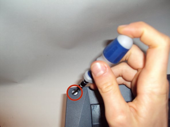

    • Once the scanner lid is removed, use the Philips #1(Torx on some printers) Screwdriver to remove the screw.

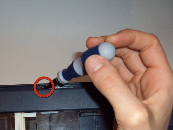

    • Remove all four silver screws from the corners of the scanner glass cover with a T10 Torx Screwdriver.
    • Organization is everything. Remember to have your iFixit Magnetic Work Mat next to you. It will help keep screws organized and in place.
  7. HP PSC 2410 Photosmart All-in-One Printer Scanner Glass Replacement: crwdns2935265:07crwdnd2935265:01crwdnd2935265:01crwdne2935265:0
    • Once you have removed the four torx screws, gently lift the scanner glass cover from the printer's base.
