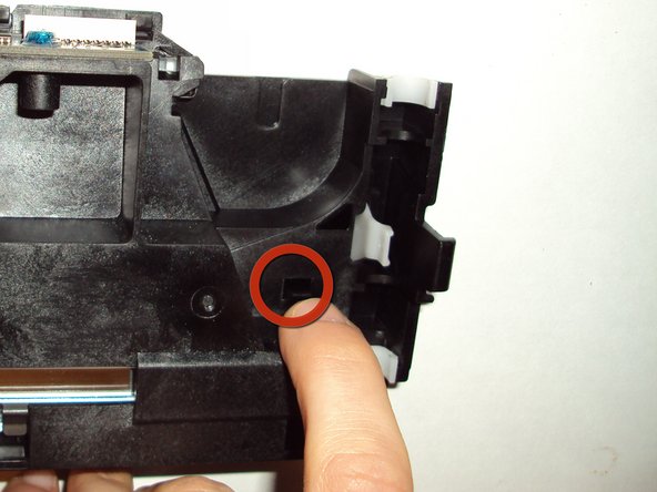

  10. HP PSC 2410 Photosmart All In One Printer Scanner Lamp Replacement: crwdns2935265:010crwdnd2935265:01crwdnd2935265:01crwdne2935265:0
    • Remove the control panel from the scanner head.

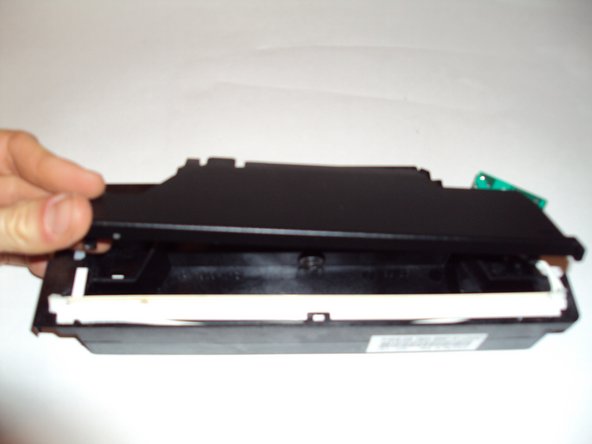

  11. HP PSC 2410 Photosmart All In One Printer Scanner Lamp Replacement: crwdns2935265:011crwdnd2935265:01crwdnd2935265:03crwdne2935265:0 HP PSC 2410 Photosmart All In One Printer Scanner Lamp Replacement: crwdns2935265:011crwdnd2935265:02crwdnd2935265:03crwdne2935265:0 HP PSC 2410 Photosmart All In One Printer Scanner Lamp Replacement: crwdns2935265:011crwdnd2935265:03crwdnd2935265:03crwdne2935265:0
    • Remove the black face plate from the scanner head. Push on the two black tabs located on opposite sides of the scanner head. One of them is located in the groove the control panel normally rests in.

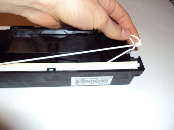

  12. HP PSC 2410 Photosmart All In One Printer Scanner Lamp Replacement: crwdns2935265:012crwdnd2935265:01crwdnd2935265:02crwdne2935265:0 HP PSC 2410 Photosmart All In One Printer Scanner Lamp Replacement: crwdns2935265:012crwdnd2935265:02crwdnd2935265:02crwdne2935265:0
    • Carefully twist white scanner lamp support out of its carriage and replace it with a new one.
    • Note: Scanner lamps are fragile and should be handled with care.
