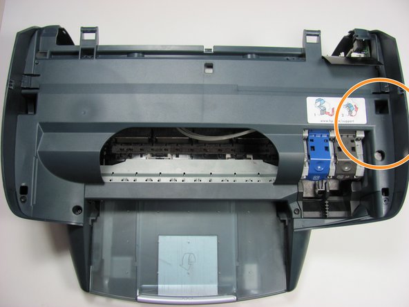

  10. HP PSC 2410 Photosmart All In One Printer Encoder Strip Replacement, Encoder Strip: crwdns2935265:010crwdnd2935265:01crwdnd2935265:02crwdne2935265:0 HP PSC 2410 Photosmart All In One Printer Encoder Strip Replacement, Encoder Strip: crwdns2935265:010crwdnd2935265:02crwdnd2935265:02crwdne2935265:0
    • Locate the panel labeled with a HP support link sticker.
    • Release the tab by the support link sticker.
    • Remove the black screw below the tab.
